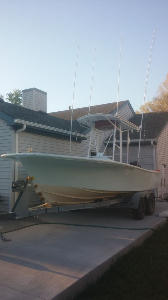

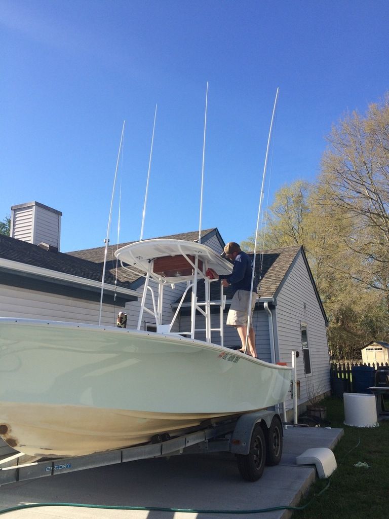

How much head room do you have? From one of the photos you posted it looks to me like your going to have to remember to duck when you come out from under the new top, or that aft diagonal bar might just help you to remember next time?

To be honest i have never noticed the bars being in the way.....now that you say something i will smack my head on it! Lol!

Looking great.... just remember to lower those antennas when you are trailering... one underpass and you can kiss those babies goodbye. Put a note on your windshield the night before you are going out so you cannot forget.
