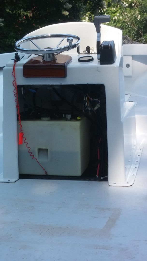

Here is a picture of my 32 gallon main tank after running 72 miles out of rudee inlet on 2 seperate fishing trips! This suzuki 140 hp is amazing!!!!!!

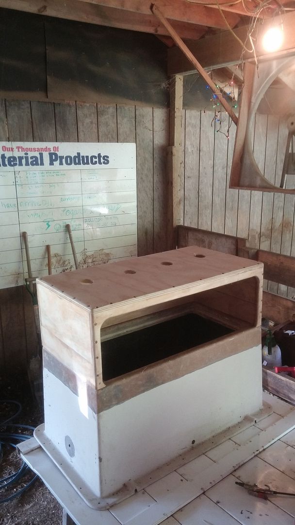

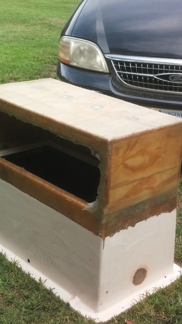

So this boat is starving for storage and rod holders. Basiclly what i did here was build a box out of ply over top of a wellcraft benchseat. This gonna allow me storage underneath, day storage in the opening in the back and rod holders on the rocket launcher design. Think im gonna do a live well out the back with a cushion on top of lid also. Im gonna use a old pickle barrel as a mold and then glass it on the back.

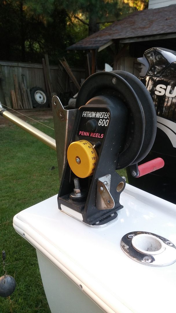

I didnt want to mount/bolt a base for my down rigger permanently to my boat. So lastnight i confifured a mounting style bracet that allows me to bolt my down rigger thru my hawse pipe.
