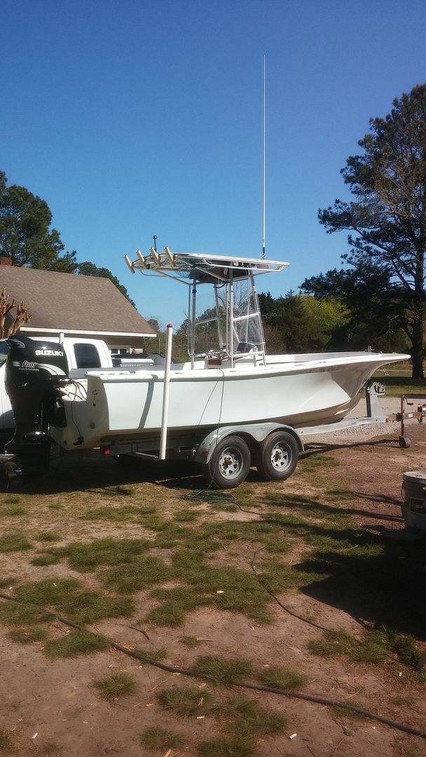

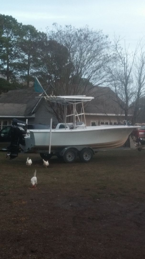

The ole girl is running awesome. I wasnt able to get the top welded up so im just gonna leave it like this till spring. The boat has performed awesome so far. We have black dea bass and tog fishing alot lately.

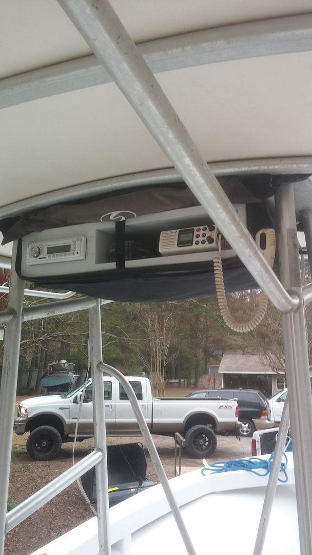

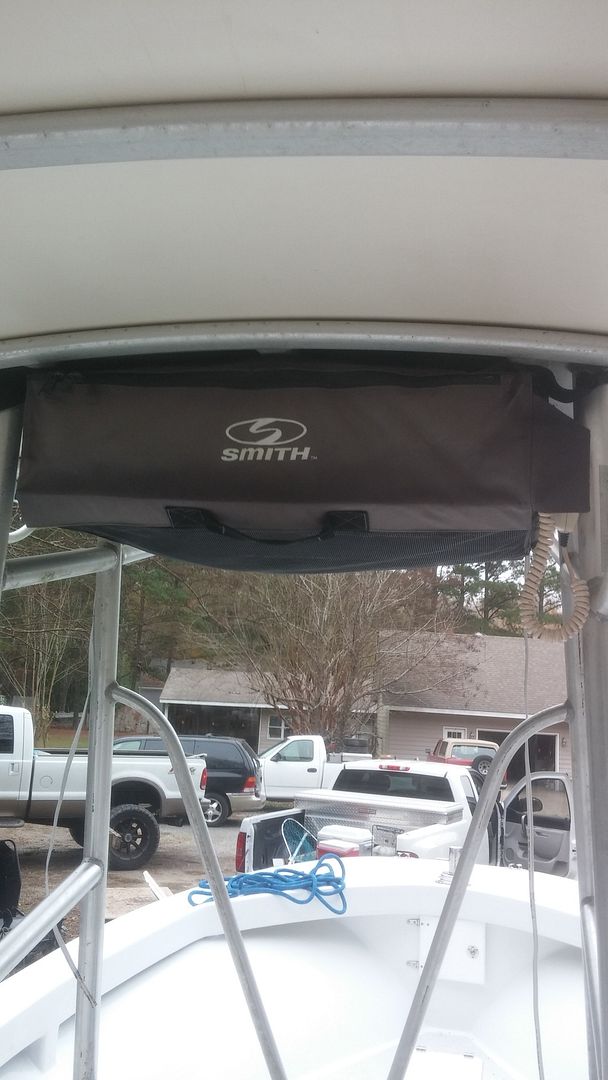

I searched hard for a affordable electronics box for my t-top. So i decided to convert my Smith t-top bag to a cheap functional electronics box. Here is the finish product. It turned out perfect. All i did was build a wood insert for the bag.

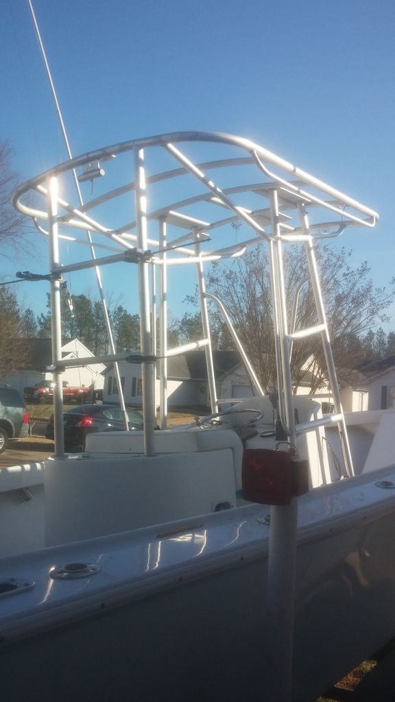

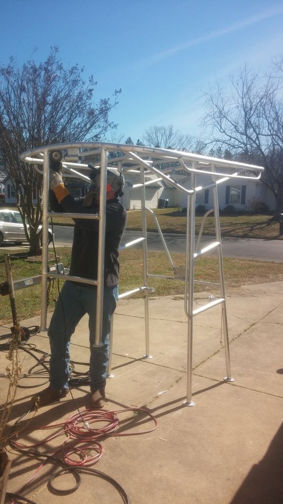

Well fellas the v is under the knife again. 2 years when i put the t-top on it was temporary meaning i put it on to fish taugs for winter with future plans of removing it and adding a ladder in the rear to allow me to acces the top for sight casting cobia and then powder coating the frame and putting a new top on the frame. Well that time has come. I got a smokin deal on a leaning post livewell so i incorporated my rear ladder/legs to bolts to the livewell/leaning post
Heres what it looks like mocked up and ready to weld.

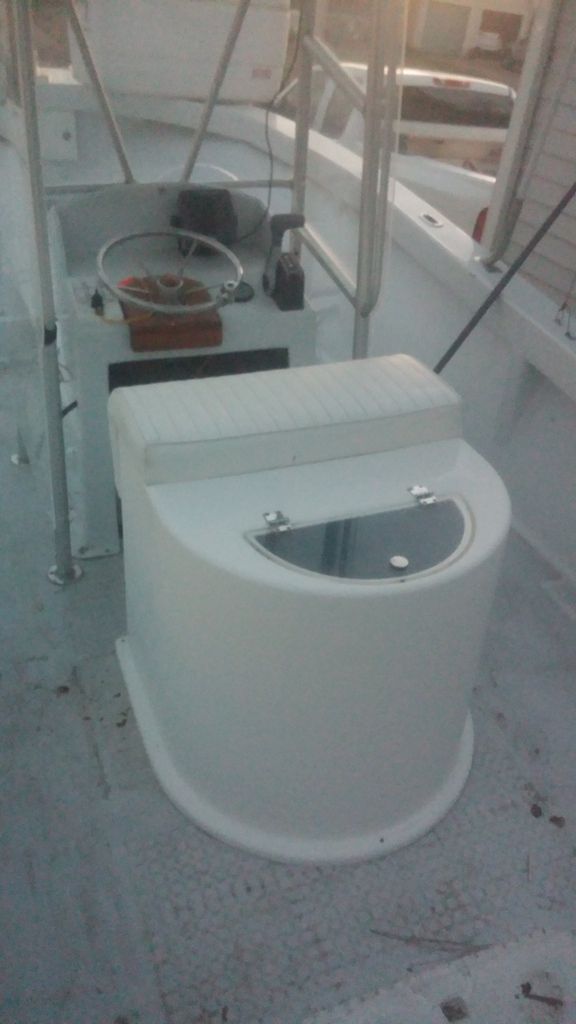

So the new livewell/leaning post is getting a little make over. I cut out and installed a insert for my fire extinguisher. And also cut out a access hatch out of the front of the leaning post for a small storage space. Cant have enough storage on a boat like this.
