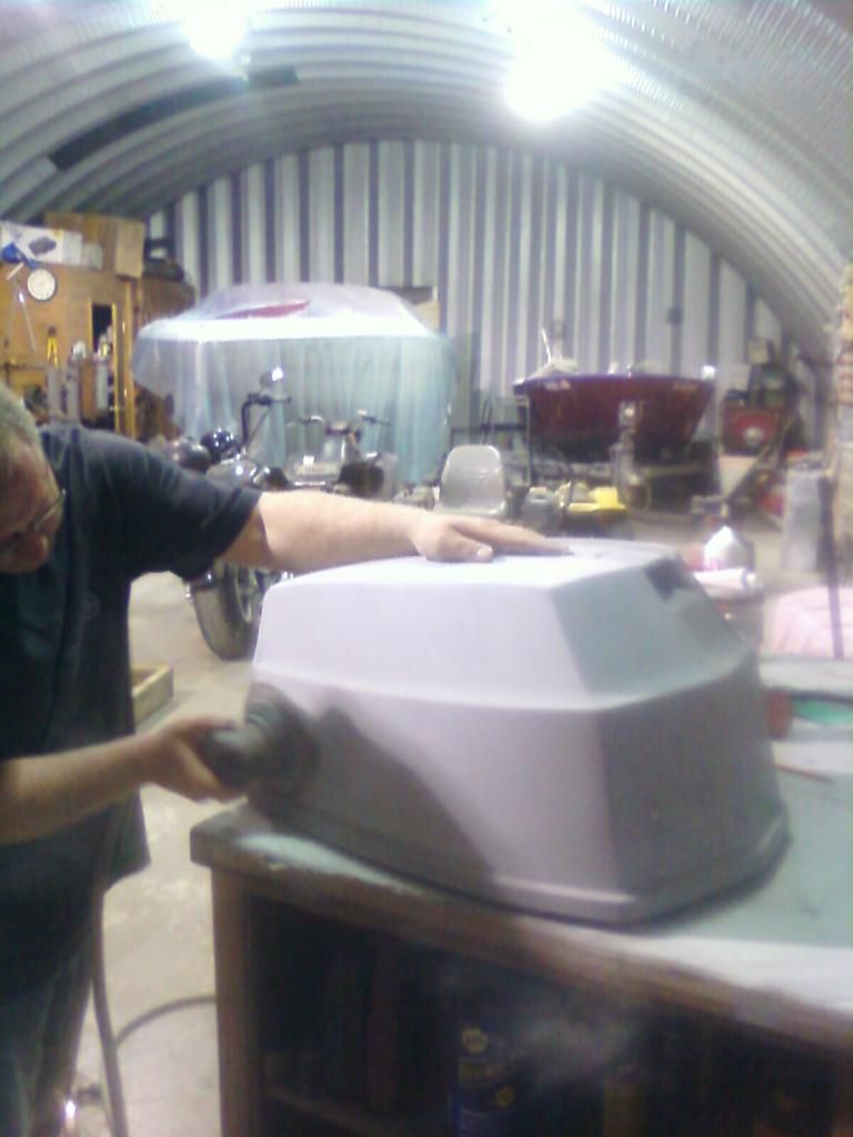

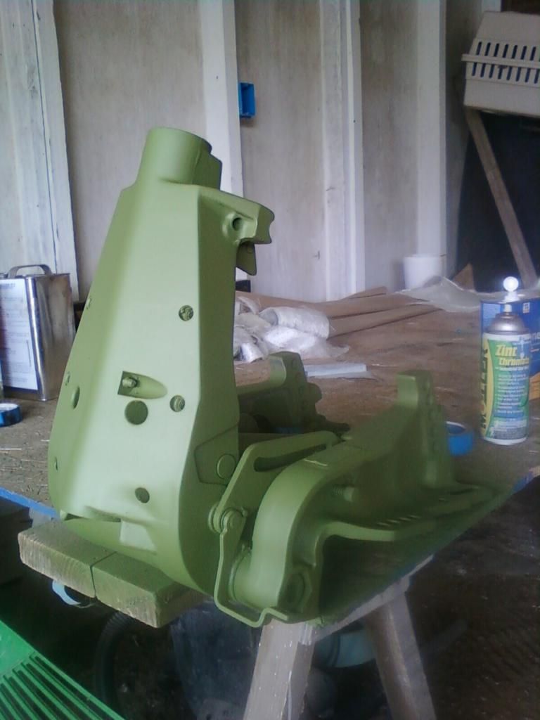

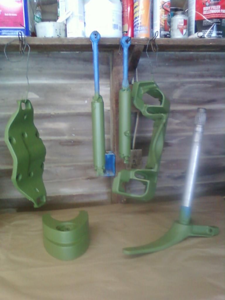

I actually have 2 projects in 1 happening on this boat. Im also astetically restoring my 1975 135hp evinrude. The whole lower end is getting new seals and painted. the trim and tilt bracket was sand blasted and shown here is etch primed as of today. the whole motor will shot with epoxy kote and then painted Evinrude White. heres some pics of the process.

You do some GREAT WORK, Kracker!!...just me, but if I's paintin' motor and boat, I'd paint 'em same color instead of two different whites...like I said...just me...I can't wait to see it if it PINK!!...lol...:party:

reel the boat is gonna rolled with gelcoat and not painted. I might just paint it with a brightside interlux white
Nice to have it all coming together at the same time! I'm going to have to wait a season to fix my cowling up. I wish you would go ahead and shoot it with some pearl white so you can tell us how you ended up with great results and save me some reading and sanding. Pearl white with new decals sure would look sharp reflecting those under-gunnel lights
Setting aside the process...I just always thought boat color and motor color when the same looked pretty cool custom...;)
