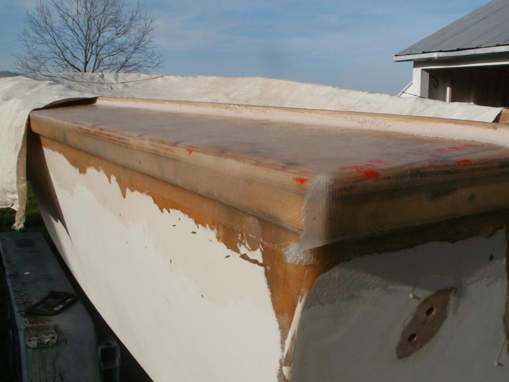

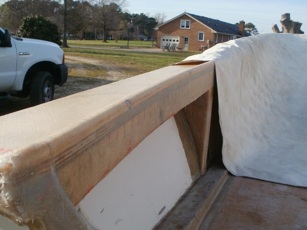

Finally worked on the boat today. Glued the wash rail down and then glassed the whole cap from inner rail and into the exterior of the hull 1 1/2 inches.
I glued the bow cap on today and the wash rail. I will be prepping the cap and getting it ready to glass in the whole thing on sunday. getting closer boys!!!!

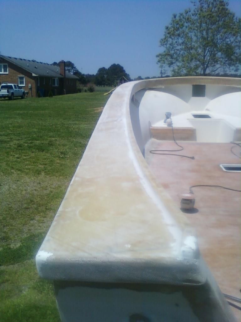

glassed 8 more feet of the covering boards yesterday. Each little bit of work i do gets me closer to finish. After all the glass work is done I will have help fairing the boat out and painting it. will have pics later
well I am happy to say that all the structual glass work is done!!!!!:sly: Its a skim and sand game now. Im gonna be rolling gell coat on the top side of this boat, 3 coats wet on wet and a 4 final coat all coats will be with waxed gelcoat. It will be gelcoated in sections, the cap will be done and completed then the the side walls of the liner will be completed and then the floor. I just dont want to paint the inside,Its a pain in the @ss and the gelcoat will be alot more durable. I also have decided im not vc performance epoxing the bottom. The gelcoat is in pretty good shape and some spots will need some attention with some matching gelcoat. I will be matching and blending my own, I wanted to learn how to do this anyway. Can I call wellcraft and get a gelcoat match from them? 1974 is a long time ago! lol!

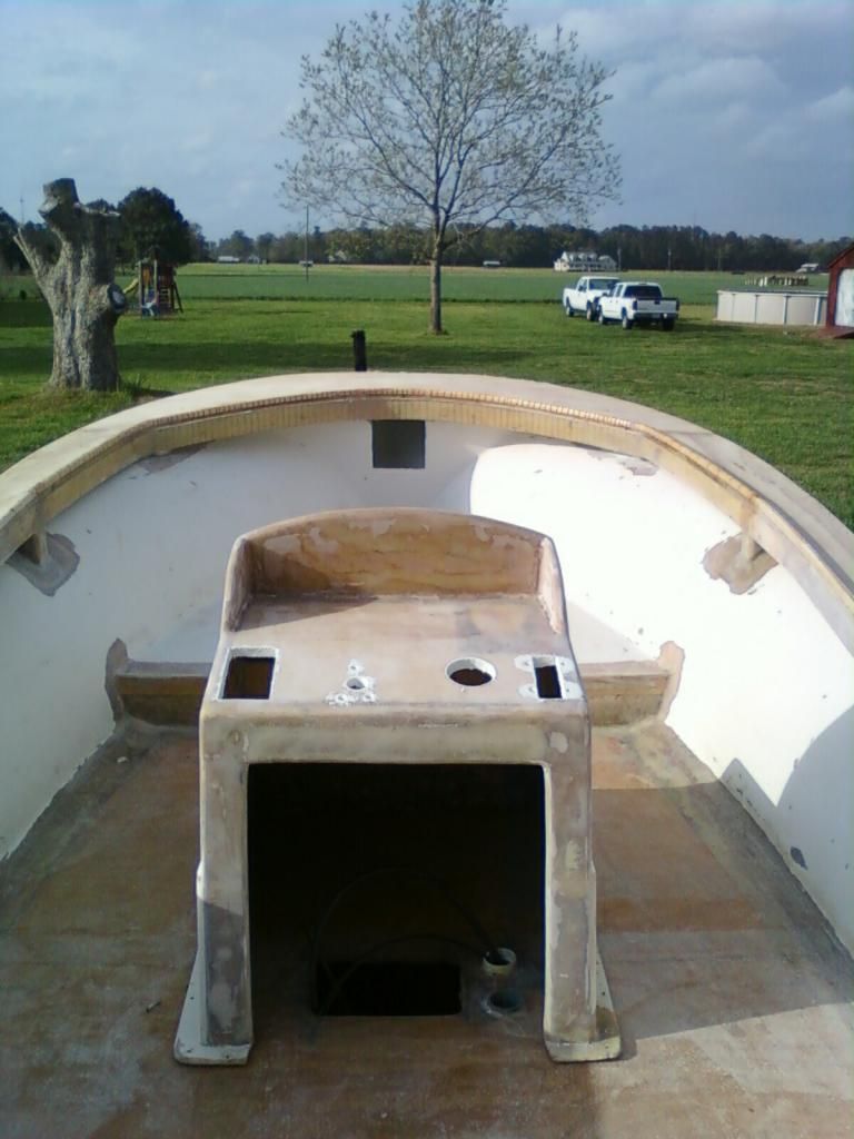

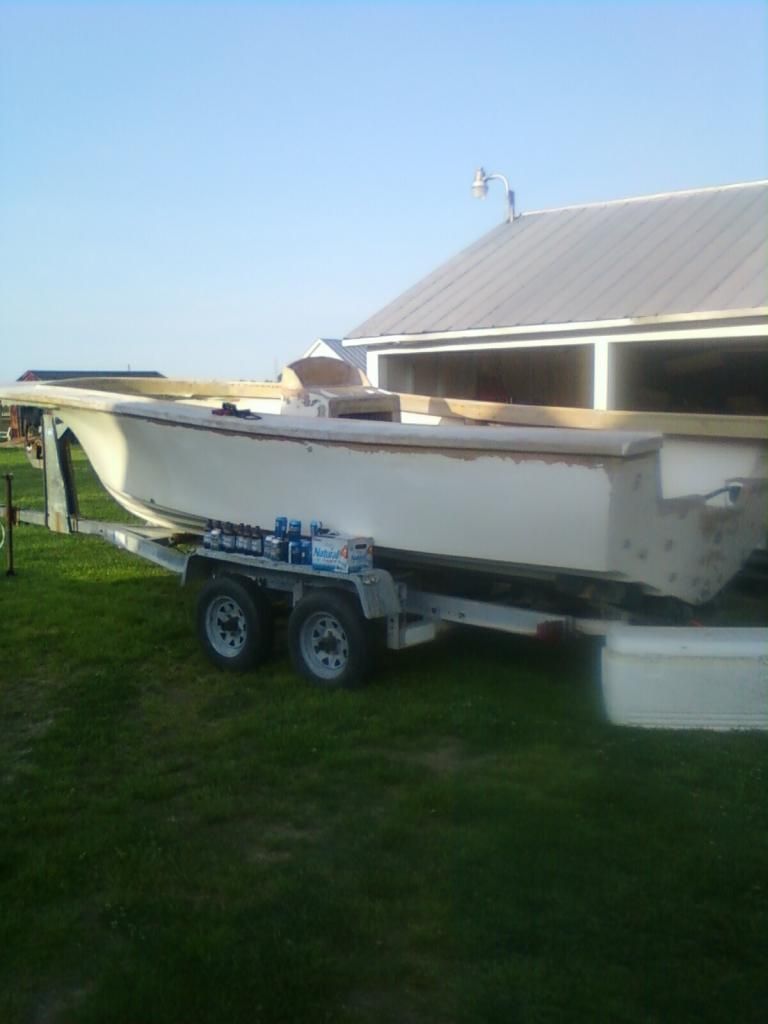

all glassed up and roughly blocked in.

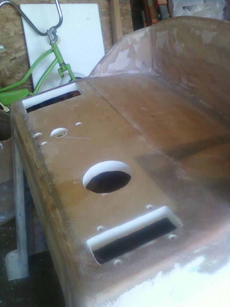

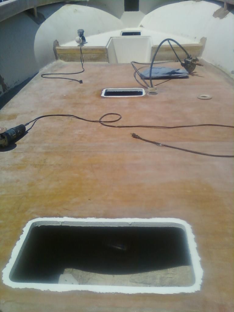

as you can see the floor penatration have been hotcoated then one strip of CSM around the perimeter and 3 coats of gelcoat.
all holes that go thru the core ply are hotcoated and 3 coats of gelcoat are to follow. the key is to seal up all wood properly. all holes holes in the transom are treated the same. the holes on the transom are over drilled by a 1/2 inch then refilled with a fiber reinforced thickend resin then 2 layers of CSM are glassed on like patches on both sides. I then redrill my holes and its protected by a 1/4 inch ring of glass. then i put 2 coats of gelcoat on the holes. Its completely overboard but I just want to protect my core ply
Lookin good Kracker! That console really gives that custom look!
You also have EXCELLENT taste in beer my friend, nothin' beats an ice cold Fatty Natty!!
