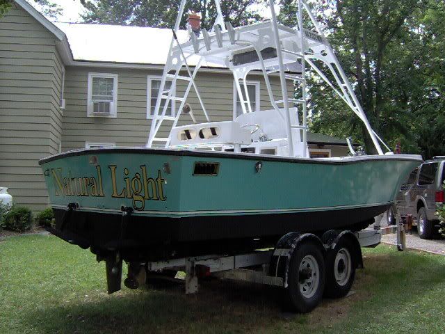

Proper primer for aluminum is zinc chromate. Two coats, first coat up and down, second coat side to side..that way there are no highlights. There are several other types also, including epoxies, but the US Navy uses zinc chromate ... and most of their equipment seems to get a lot of salt usage for some reason.
Exactly what I did when I painted my half tower on my 236 Mako. Followed the 2 coats zinc chromate with 2 coats of Interlux Perfection.
Closer
Draglink - "A fine pilsner beer" indeed. Nice rig. Thanks for sharing that, you still have the Mako? How did it hold up with that paint system? Kracker that top is a find.
Unfortunately a guy from Richmond threw a crazy amout of cash at me and I sold her....I still regret it, it was the best boat I have ever owned (ok tied with my V:love:) , had her for 12 years. I sold her 2 years after I painted the tower and there was not one chip. The only flaw was where my 16' VHF ant rubbed through
Drag, so you went with perfection. I was thinking about using the same paint on my t-top that I'm gonna use on the bottom which is VC performance epoxy. Nice boat Drag! I will also be starting the prep for spray shield this weekend like your Mako console has!!!!! That is sweet!

Thanks guys, she was sweet thats for sure! I think the VC will work, but wont have as high gloss as Perfection. The windshield is so low on that console I just turned it into a spray shield....I like how it turned out also.

What is your spray shield made of?
Its just the plexi-glass windshield that I put a layer of glass on the inside for strength, then faired it out smooth

I like the white painted frame Drag.
There was another famous boat also called Natural Light.
