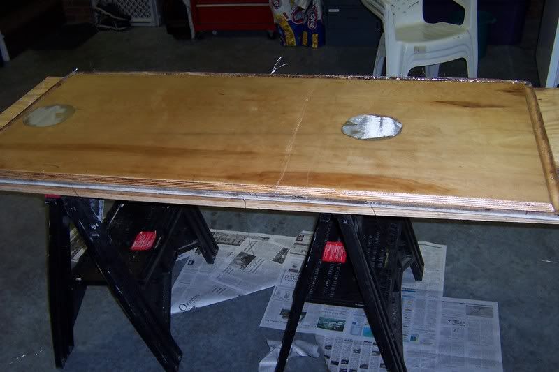

Here it is without the weight

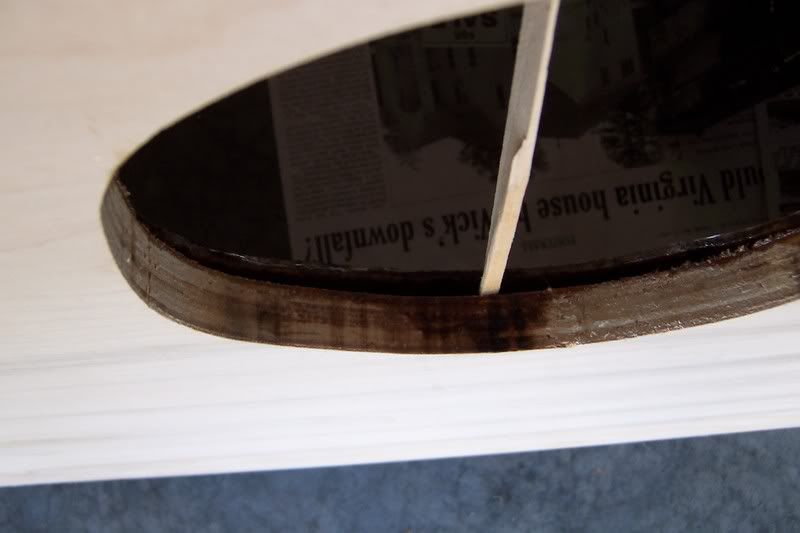

Uh-oh, we got a problem >:(
It may be hard to see, but there is NO BOND where I have that piece of wood sticking in. It goes all the way to the outside edge and for and aft at least 18". I mixed up a hot batch of resin and dumped it in the hole, then set some weight on it.
I dunno what happened exactly, but it looks like I just didn't have enough of the sticky stuff on there and the wood soaked up some. Well, I'm on hold until this sets up, but I am going to end up with some unbonded "pockets". I'll just get her sealed up the best I can and hope she makes it 4 or 5 years. More to come tomorrow.
might have had too much weight and pushed the resin out. i've done that with clamps before' either way. its better than it was.

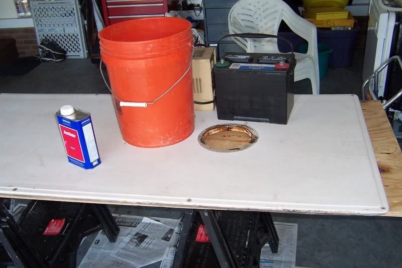

OK. it setup quicker than I thought it would, so I got to it.

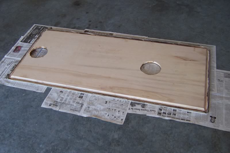

Flipped over ready for some resin

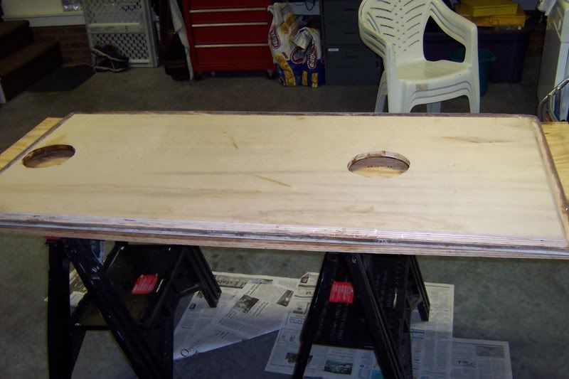

And here it is with resin and cloth applied
The freebie mat I got was real heavy roving with matting applied to one side. Way too heavy for this job, it would be great for stringers or maybe even a transom. I might try it when I rebuild my battery and trim pump shelves.
