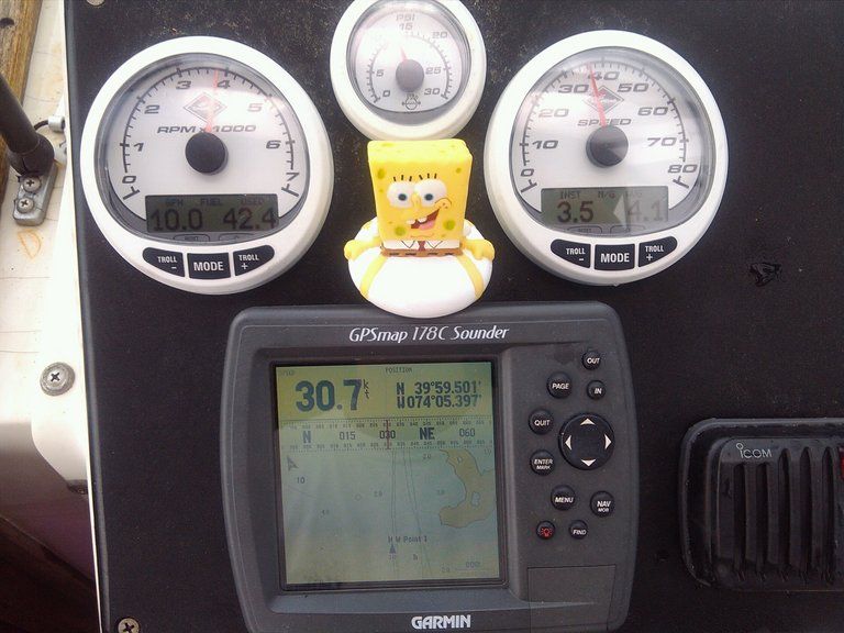

I have a 225 Optimax on my V. Right now I'm running a Merc Revolution 4 prop with 19" pitch. My top end is 53mph occasionally hitting the rev limiter. But the cruise is perfect. 30kts at 4000 rpms and getting 3.5mpg.

Nice looking numbers Pete. And a good looking dash setup as well.

I can just about see Spongebob now. Jetting across the harbor with that new powerplant.. Sweet dash job too capt Pete.
