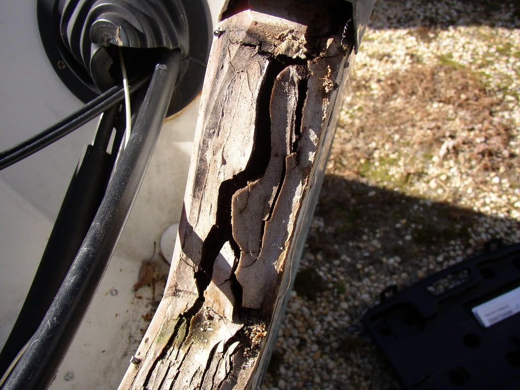

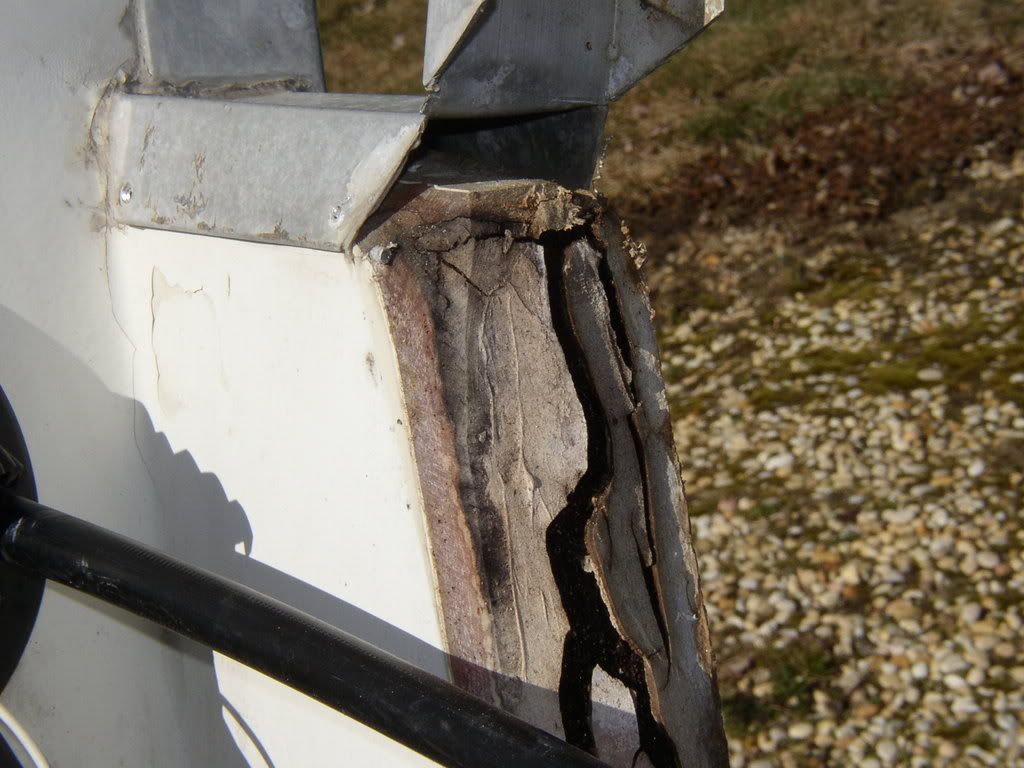

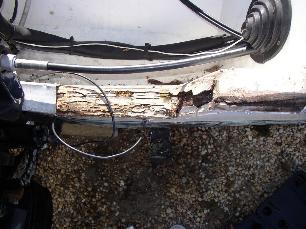

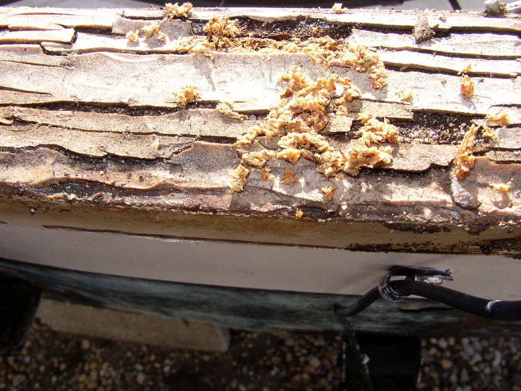

Attached, I think/hope, are some pics of the transom under the cap.
I drilled down about an inch or two and the shavings seemed to clean and dry.
