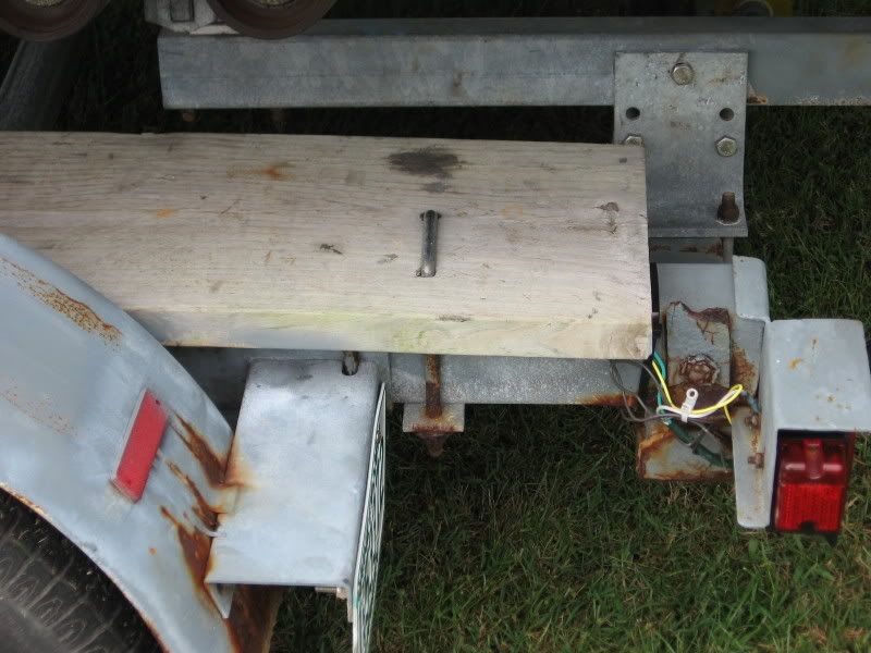

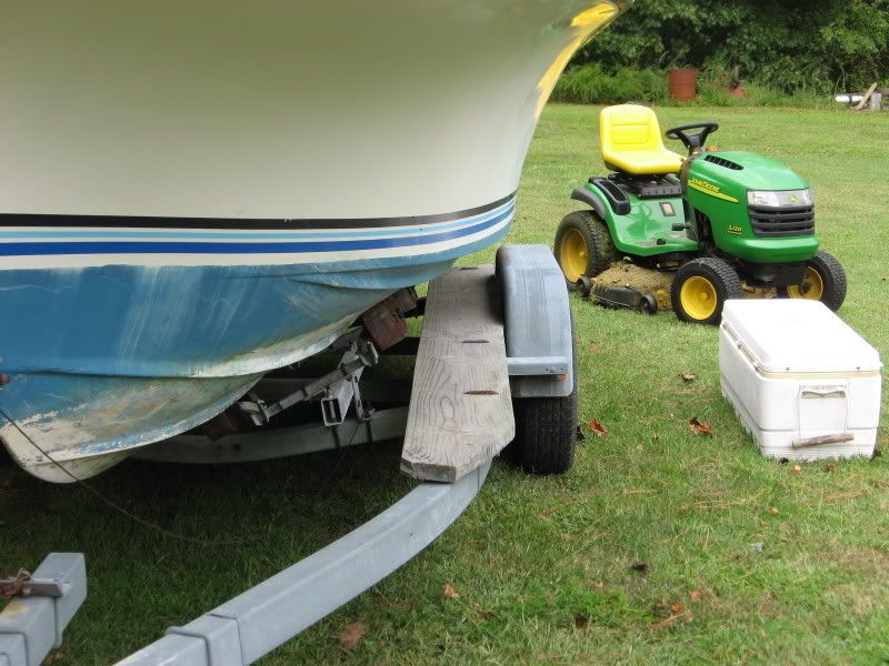

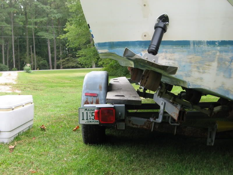

Me and Turbo were talking about trailer walk boards so I snapped a few pics and figured I'd post how we do it on the 'shore. Mostly roller trailers around here and we try to back them in so that the hubs/brakes don't get wet. I've got a string from the power winch to the end of the trailer that lets me run the winch from the end. The board is a treated 2x10 that held to the frame with ubolts.
On mine, the board may be a 2x8, I can't remember now. Anyhow, keeps from getting cold wet feet whilst chasing big rocks, bass for you yankees, in cold weather.
