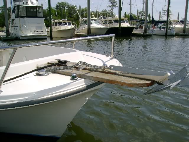

i have to tell you that is one beutiful boat. It doesnt matter how old the wellcraft is its still beutiful i never get tired of looking at her but tell me what kind of wood the soecs and how did you make the pulpit I would like to do it to my steplift but i hate drilling into the top deck unless im sure it will hold up to pulling out and dragging out the anchor let me know if you can

The bow pulpit is a little over an inch thick piece of teak wood. It is about 36" long so it goes all the way back to the splash dam that goes around inside of the bow and hangs out a little over a foot. I took out my bow cleat and got longer bolts so that it is still thru bolted in the deck, I used 12 more thru bolts, 6 on each side with a 1/4" thick x 2" wide piece of teak on each side as a backing plate with large washers in the rode locker. I also put in a closable rode chock so when the anchor is up I can screw the closure through the chain to hold up the anchor. I weigh 215lbs and I can hang and bounce off the tip of it when it is sitting in dry storage, so I figure that should be more than enough strength to hold my V20 when sipping on beers at the beach. I also took a couple of pieces of 1/4" x 2" teak and ran them down the center of the pulpit as a chain gaurd. It doesn't really do much, but I think it looks pretty damn good. I'll get some detailed pics up soon.

I made my pulpit out of 1 1/4" teak, about 36" long and 12" wide. It will hold all 215 pounds of me hanging off the tip of it sitting on dry land. Very tough. Pics follow here:
I have to remove it soon to refinish it. That's the only downside to using the teak, I'll get more up after the job is done.
It is called a closed chock. It is used a lot on blow boats to keep their lines from tangling too much. The top bar is threaded, so you can screw it out and release the anchor. i set it up just far enough back so that I have to pull the anchor tight and just get the screw bar into the chain. It also helps when hauling the anchor because I can keep it closed while I'm hauling the rode, and it allows me to stay farther back in the boat. If need be, I can pull the anchor out while standing at the console, in cases when it is windy and I'm single handed, then I just tie it off to the T-top temporarily.
