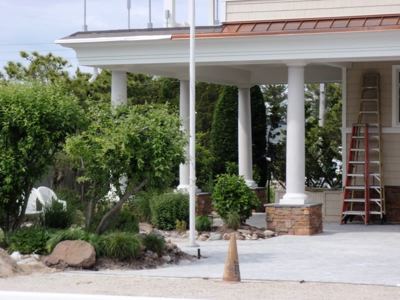

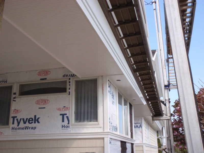

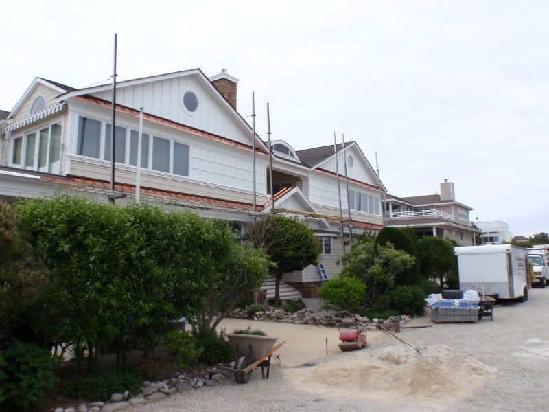

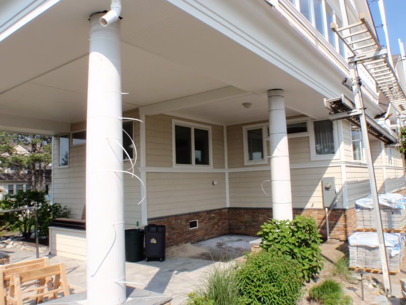

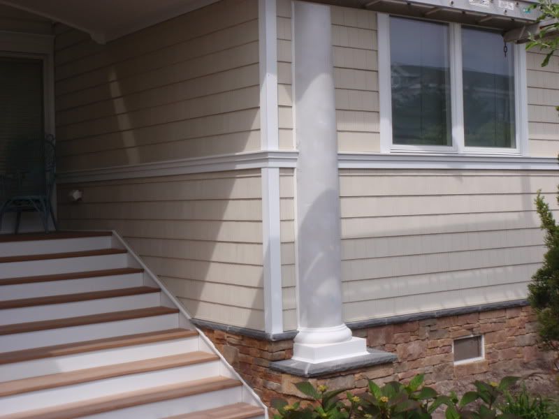

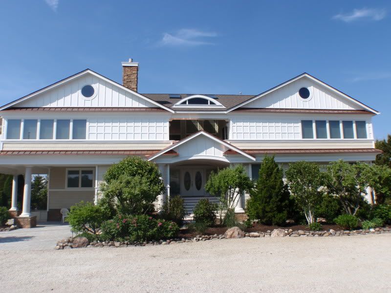

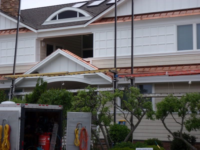

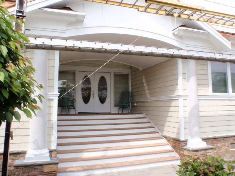

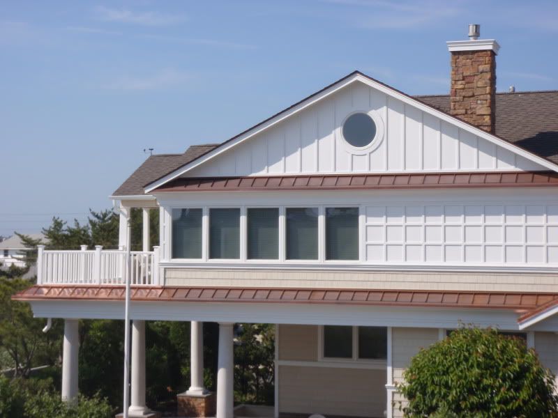

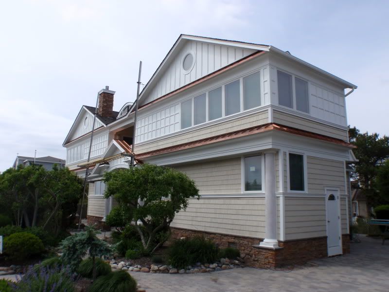

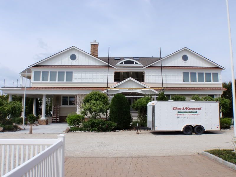

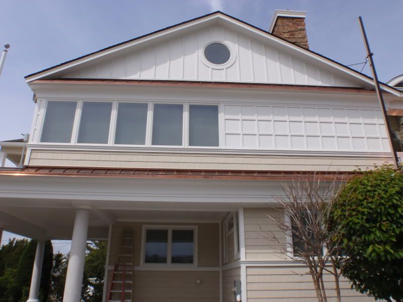

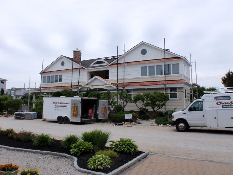

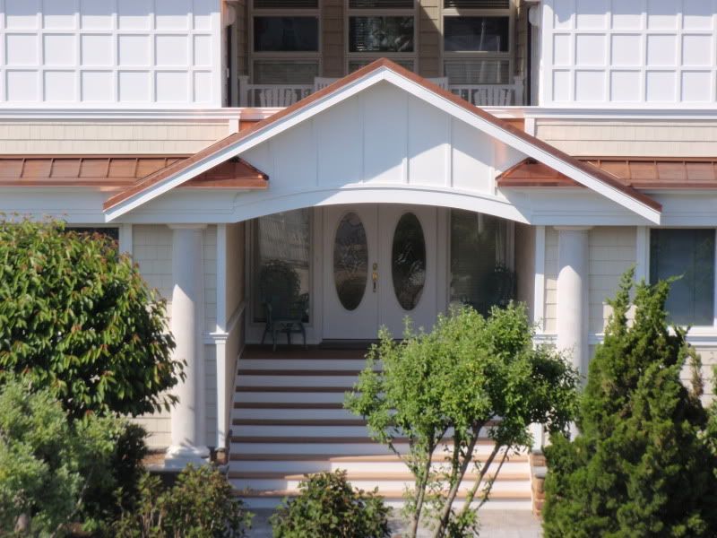

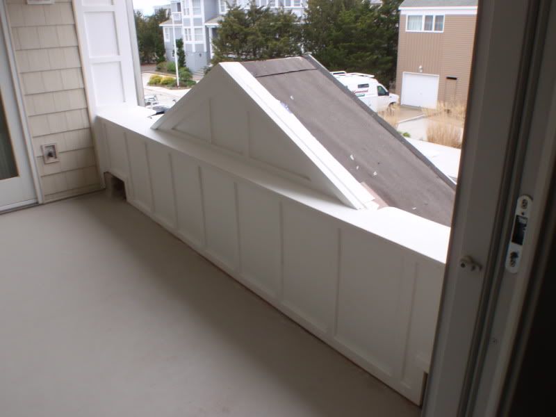

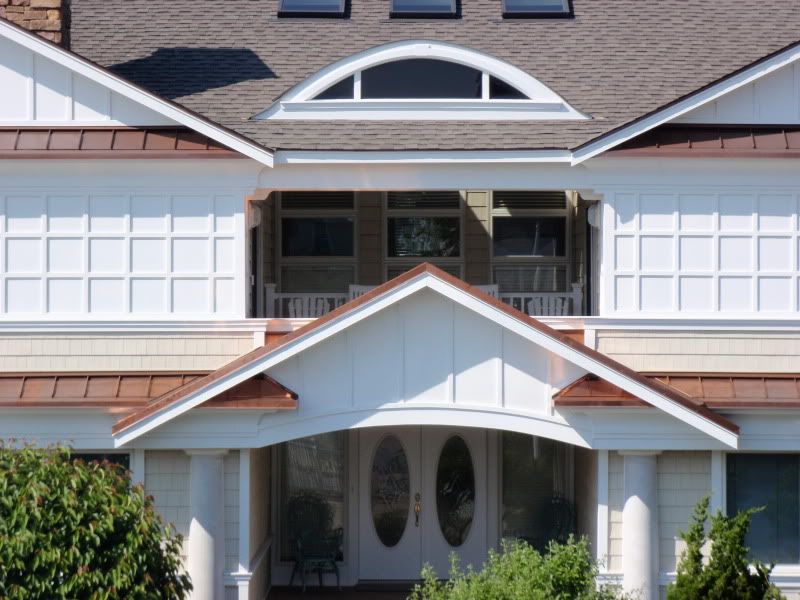

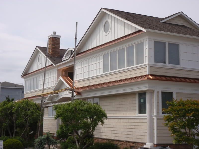

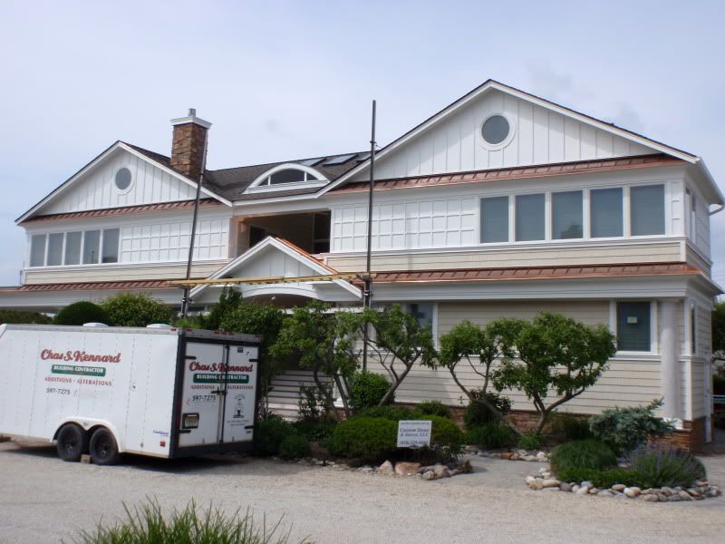

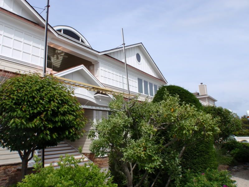

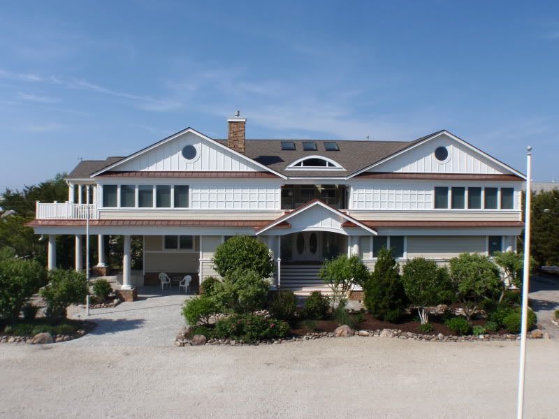

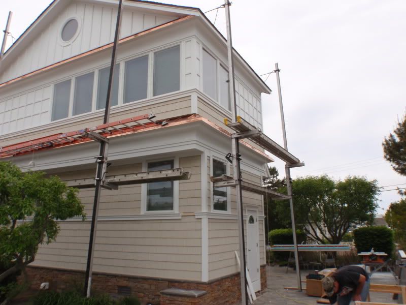

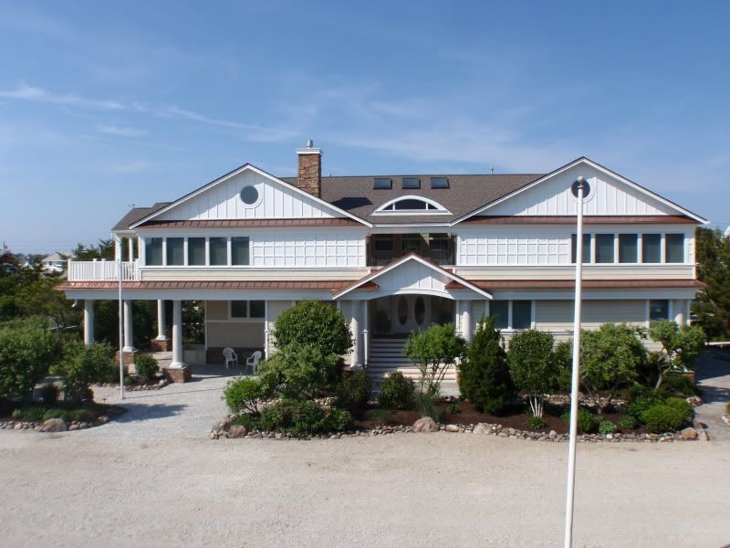

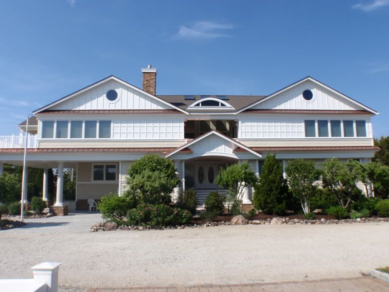

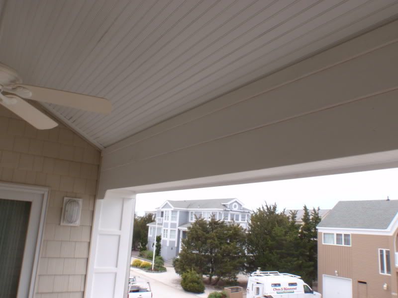

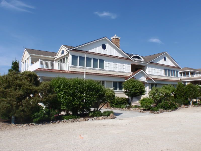

What's that exterior trim material?
There's a lot of great looking exterior mill work on that job. Are you using that new PVC stuff? What you have there looks way nicer that any lumber I'm seeing. I've seen them using PVC trim on some This Old House projects and it seems like it may be the way to get the old fashioned (clear lumber) look.
Very nice looking job.

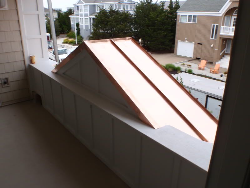

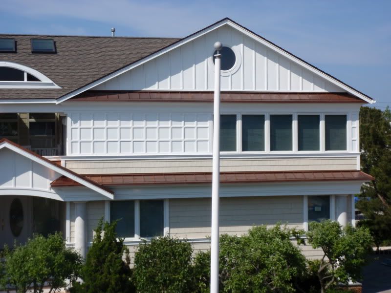

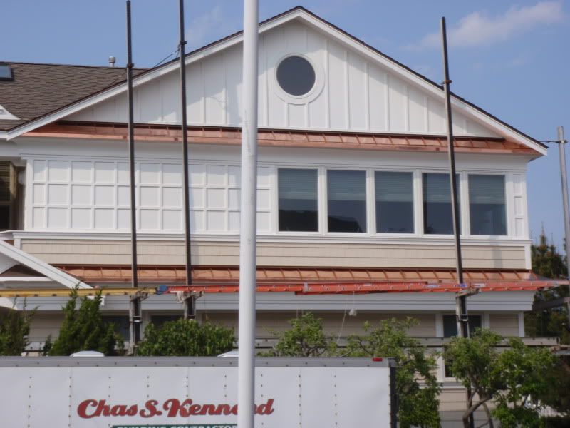

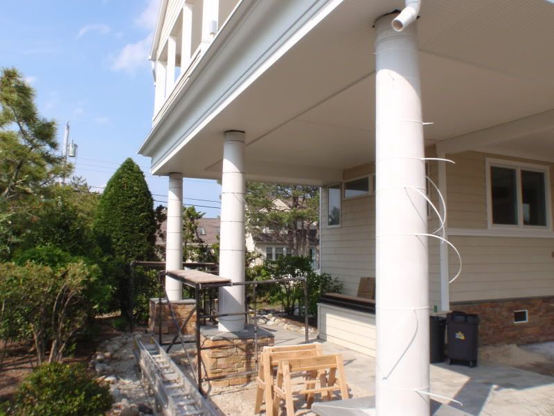

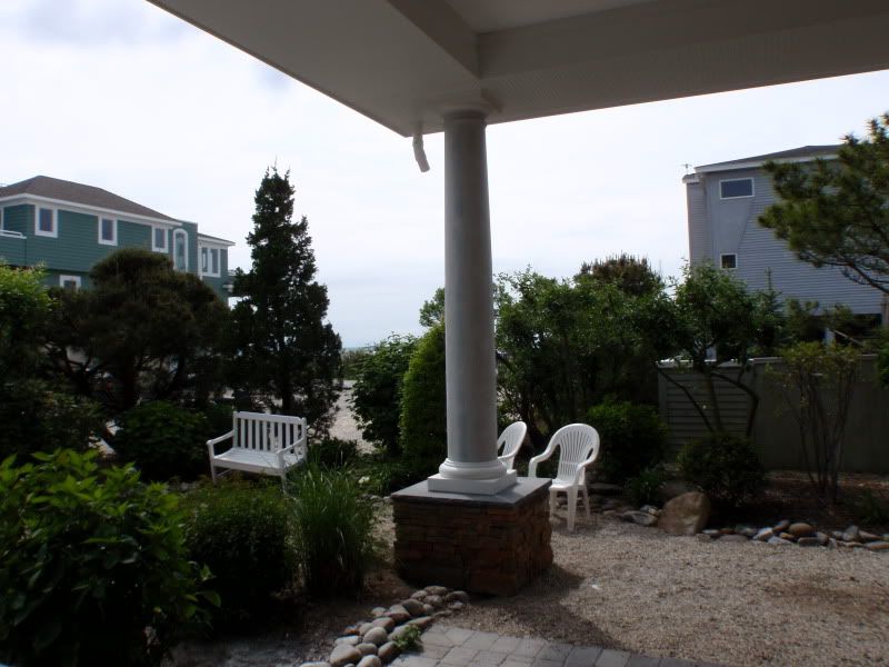

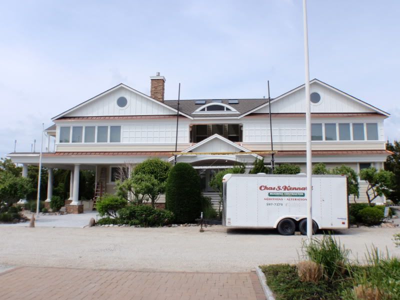

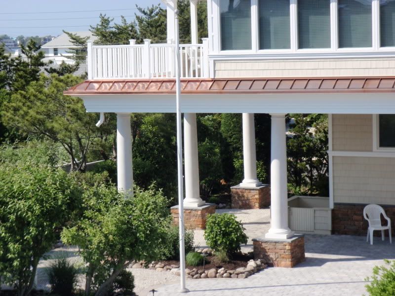

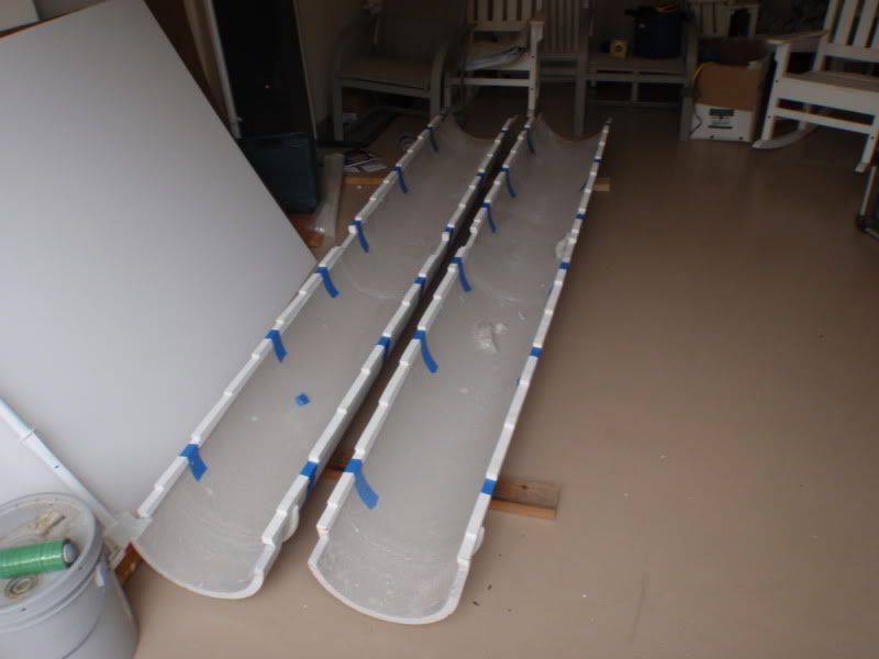

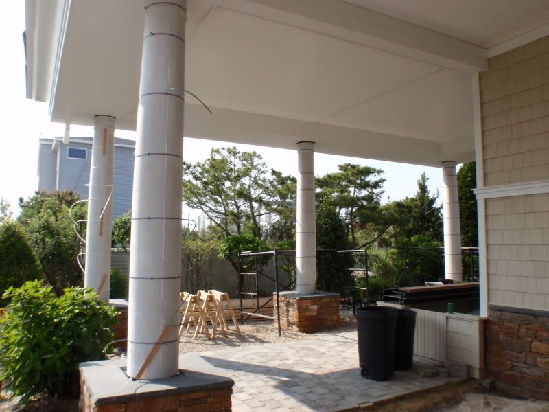

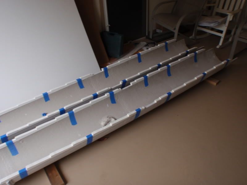

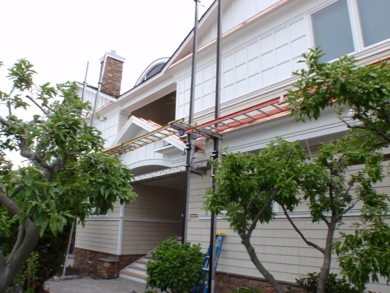

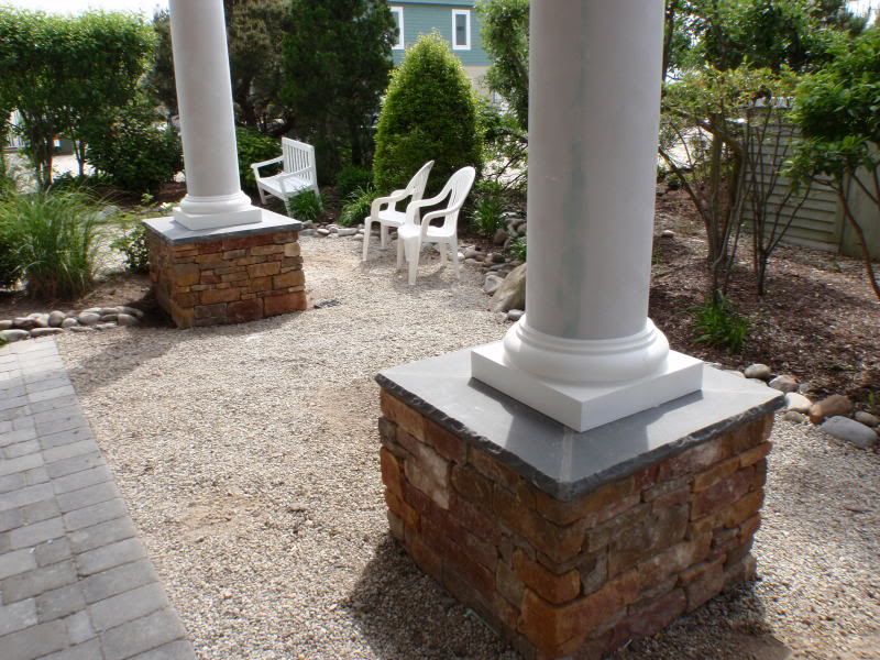

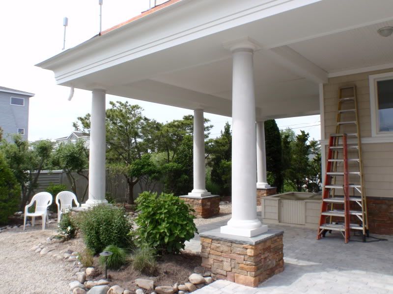

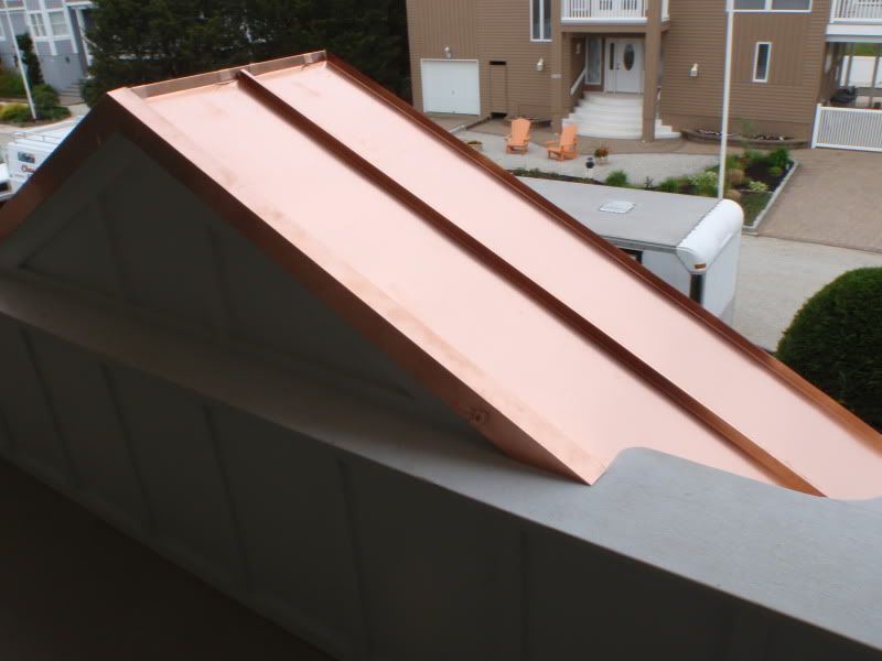

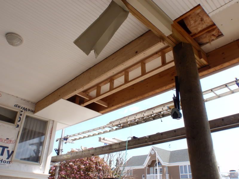

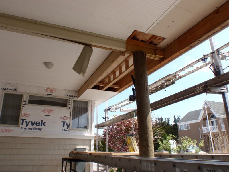

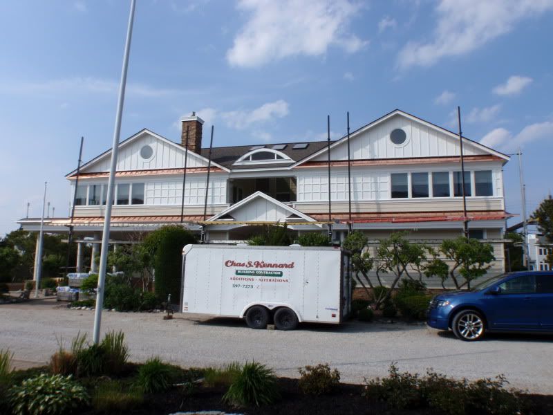

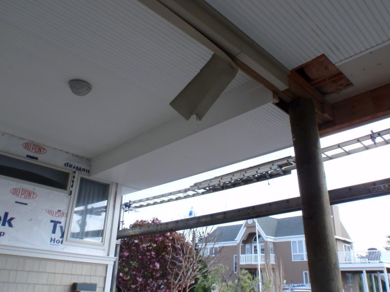

Hi Scott its all azek and fypon , there isnt any raw material , all the pilings are getting covered with split colums tapered 16 to 14 x 10' tuscon cap and base , this week the copper roof is going on ....that should change the look of the whole house.
