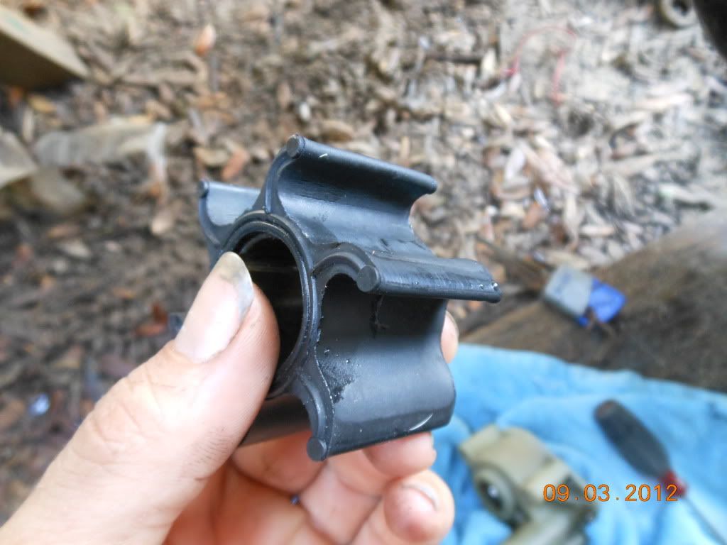

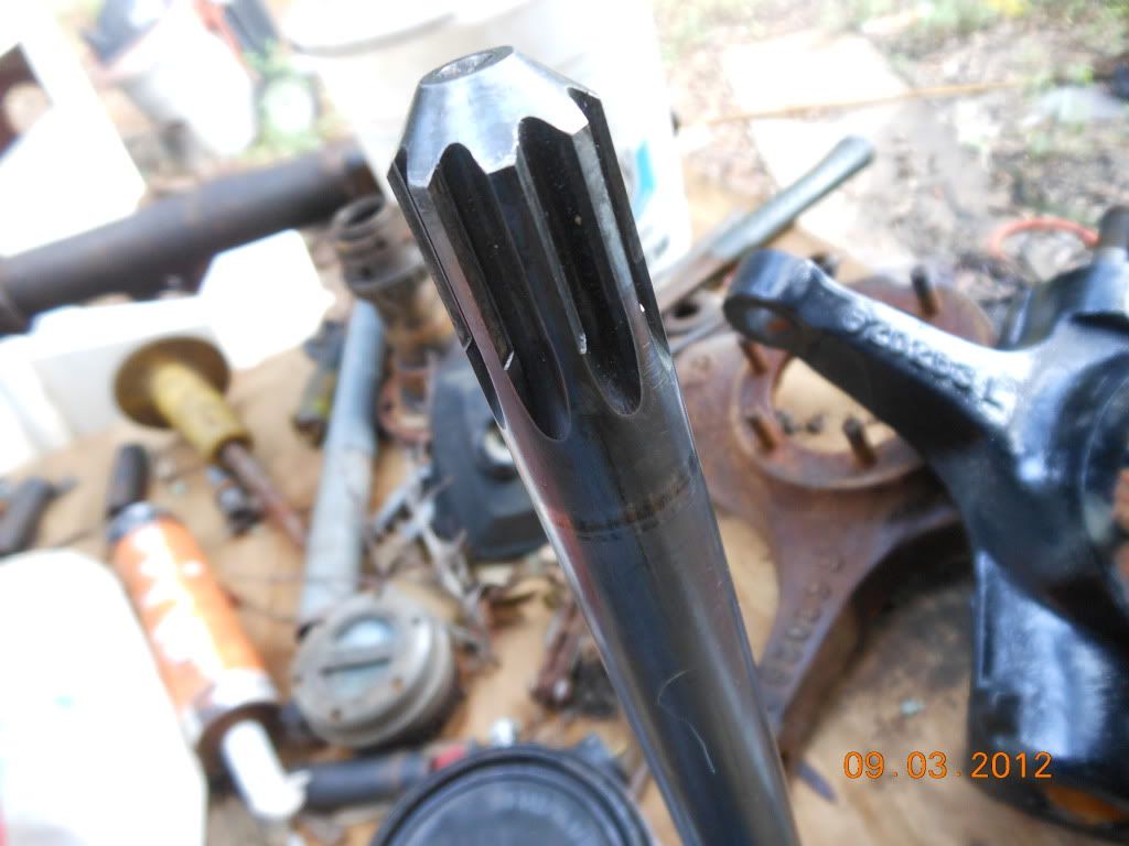

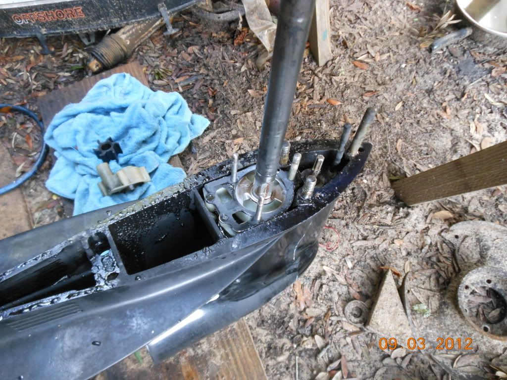

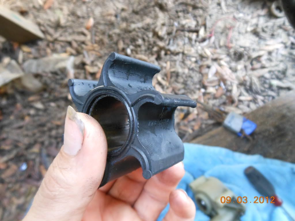

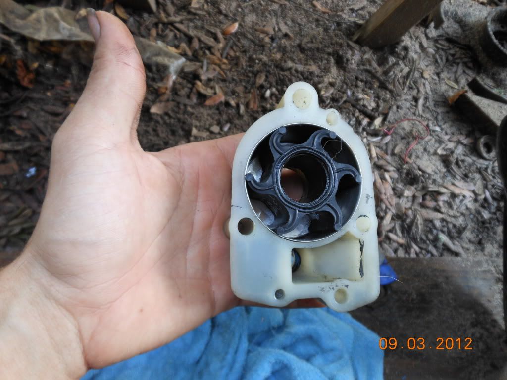

I dropped the lower, was careful to watch for anything falling, springing, flying etc. Nothing happened. Lower unit dropped right off. Got the housing off to discover a brand new looking impeller. Maybe I am paranoid after what happened. Will post pics of everything when mom gets off the computer. I was expecting a much larger housing and impeller. But like in my above post I have only done Yamahas. On the splines on the driveshaft, is it supposed to have a groove on the side of the splines? They all look too perfect to be wear. And I had a blue oily crap on the front of the mating surface of the lower unit. Based on it being blue is it two stroke oil? Also how much up and down play should I have in the driveshaft?

Housing after i pulled it
Views of the impeller
You can see the blue oily crap on the shift shaft end of the lower unit.
Driveshaft splines with grooves??

Looking at your impeller, it looks fine. There's a little wear on the spline tips, but nothing that would cause me to worry. The fact that you had water running thru the muffs is probably what saved it. Don't forget the water is the lube for the impeller, so since it was wet it didn't suffer the damage that a dry impeller would.
Yes, the driveshaft has splines on the top... they mate with the bottom of the crankshaft. No, they are not supposed to have grooves..that's wear. Nothing you can do about it except replace it, no way to repair it cheaply. But based on the amount of wear I wouldn't worry too much. There's still plenty of meat on the splines. Put a little high temp grease on them before you marry them together again. My bet is it will last longer than your engine. I'm sure that other people may disagree with me, but logically speaking, there's no reason to spend LOTS of money on a new crankshaft and driveshaft while the old one is still very functional.

Your water pump impeller is toast. The rest is normal stuff. The Merc impeller is small compared to say my 90 Johnrude and even later model Mercs. They work just fine, just smaller. A little up and down play in the driveshaft is also normal although a little alarming to me. The lowers on these outboards are pretty darn crude.
Ridge? I'm always willing to learn. Based on the pictures, could you explain to me why you think his impeller is toast? I mean, don't misunderstand me, it's always a good idea to replace the impeller every year, and since he has it apart anyway, now would be a perfect time. But what is it in the pics that makes you think it's toast? Looking at the pics I can see a little normal wear on the leading edge of the vanes, but nothing that looks out of the ordinary to me. I don't see any cuts, tears, cracking or evidence of overheating. Am I looking in the wrong place? :head:
There is cracking very slightly where the vanes curl over. You can see it in the pics, i can get a closer pic too. That may be what he saw. I opened the housing expecting to find bits and pieces of an impeller. The driveshaft has about an 1/8" maybe a little under that of play. Also has side to side play? Is that ok?

On some mERCS taking teh t-stats out can burn one up in a hurry. The poppit valve assembly must be working for the cooling system to work, otherwise the stats can't work. And that impeller is done. The impeller vanes need to stick straight out as that is how they work. These pumps are a displacement design where the impeller fins move in and out to compress the water out and pull the water in. Once the impeller vanes get laid over like the ones pictured, it is no longer pumping much. This is most important at high RPM's as the vanes need to move in and out rapidly. And the MERC impellers are a tall but short vaned design as they are a high pressure design meant for MERCRY's poppit controlled cooling system whereas other engine manufacturers used a high volume design with longer impeller vanes that aren't as tall.

If there's any cracking then it's toast. Sad to say, looks like it had a lot of life left in it.
I did not know that Ferm. I am buying a new complete water pump. The old one is going in the box for a spare. No wonder it never seemed like it was pumping enough. Now that I look at it, the Merc impeller is tall. I did notice the housing is offset from the driveshaft and wasn't someone on here asking about that? Thanks for the info Destroyer and Ferm. Does Merc Parts offer a complete water pump kit or will I have to pay more for each piece?
