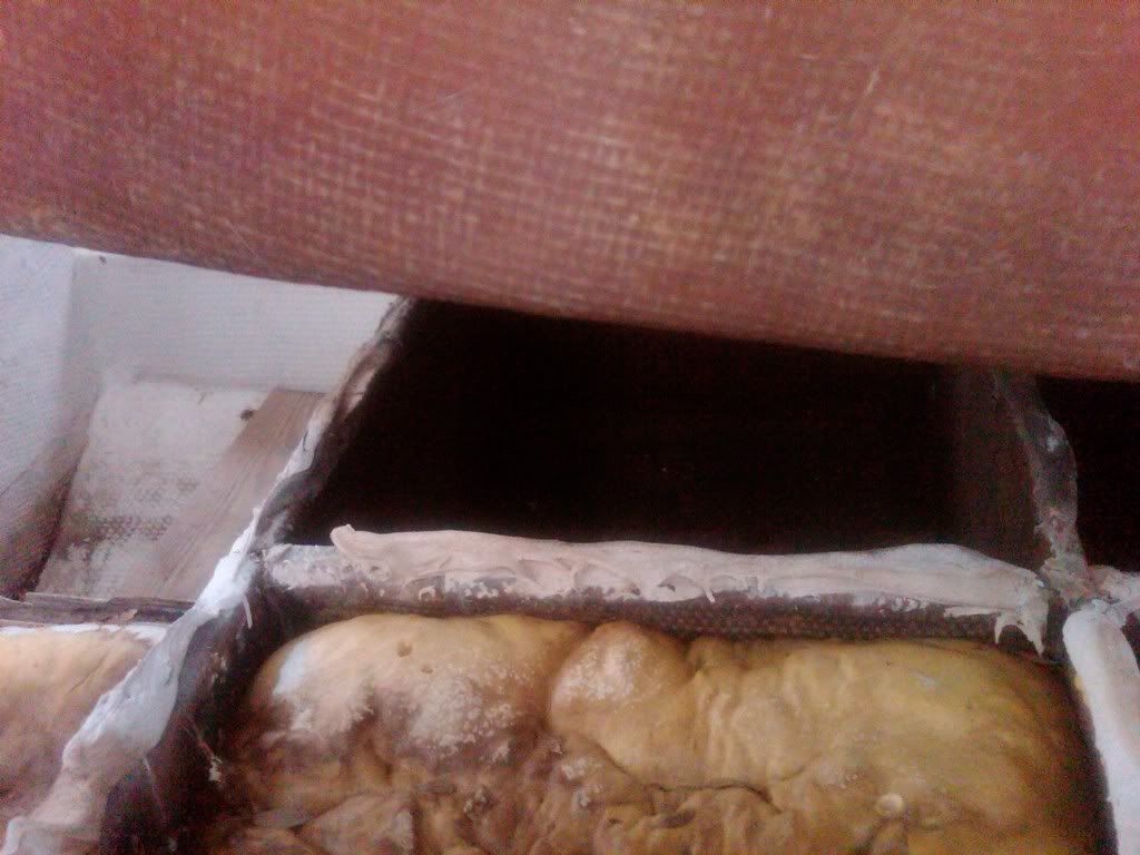

You got it. After the console, fuel tank hatch and all the rigging is removed. Someone on here hung their top cap from a tree recently. Wellcraft used a thickened putty on top of the stringers and layed the cap into it to bond the two together. I made some small wedges of wood to tap in place between the top of the stringers and the bottomside of the liner. I started in the front with the hoisting. I hope this helps.
not sure about the center console but I removed the cap on my fathers project v20 cuddy. You would want to remove the console,seats or anything else on the deck. Also remove the fuel tank hatch. The deck is bonded to the stringers and transom. You will need some good pry bars and possibly a sawzall with a long blade to cut it loose. The cap is very heavy and very awkward to lift. You will need a lot of help or a good hoist with some slings. It is a little harder at first but it is much easier to make repairs once its out of the way

if you pull the transom cap off you can probably get a sawzall blade down there. The one I did had a pretty rotten transom so I cut without disregard. Pry it slowly to minimize gelcoat cracking. I pryed the deck up and set it on blocks of wood to get the straps around it. Here are a few more pics. I dont know if they help any.

Start by removing the endcaps at the transom. Then just pull the rope out starting at one end. It will probably come out a lot easier than it will go back in. Under the rope you should find a screw about every 4 inches, or so. Remove them all. On my boat there were also screws beneath the rubrail. When you put the cap back on make sure to seal it up good with one or more tubes of 3M 5200 before reinstalling the rubrail. Fill the seam as well as all old screw holes.
New pictures of the cap removal process. Tipped it up and got the back part to seperate from the transom with out cracking. the bottom looks great, and I see why the floor got soft, looks like someone or wellcraft cut 4 big holes under the center console to be able to attach it with a threaded screw vs wood screws but didn't seal the holes. Also found a big empty spot under the front seat of the center console, never used looks like I can put another fule tank for added travel.

Did you remove the thick resin on top of the stringers that filled the gap to the floor? or did you just put your resin on top or that?
I removed all the old stuff. The stuff that was on my boat was sticky and a real mess to work around so I got rid of it all
definitely remove the old..sand down the surrounding area..mix up some new resin with cabosil and milled fibers then re-glass the whole thing....5200 sounds easy, but resin such as epoxy or vinyl ester is much more stronger than 5200...by a long shot.
