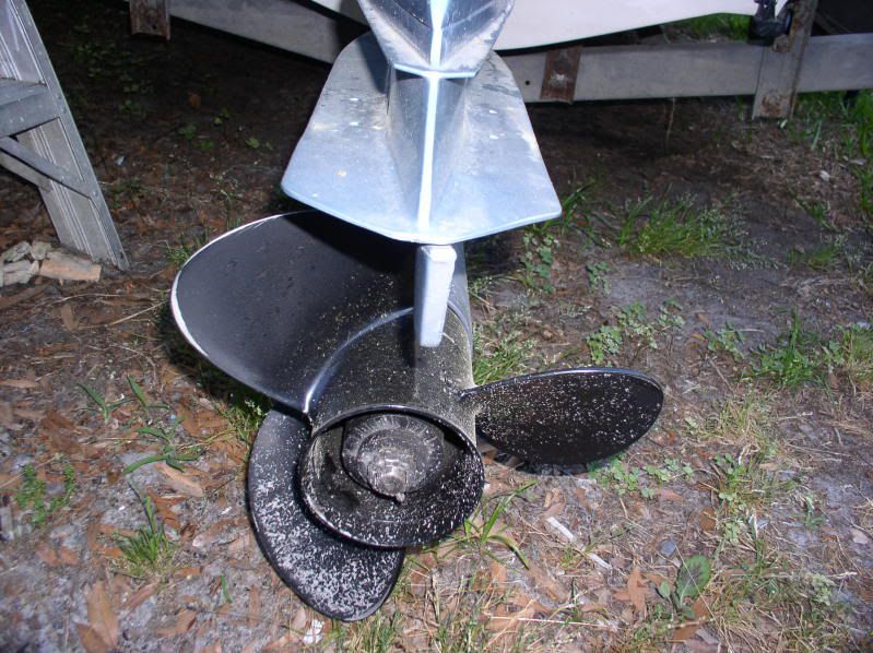

This is the normal position to equalize the torque.
