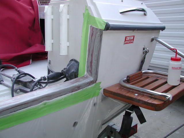

My brother in law Dan, and partner on the new E-Tec, grinds out the old filler that has cracked through the years.
Puddy has been removed.

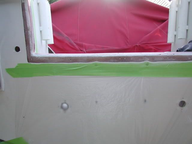

Cap was then sanded to remove the gel coat.

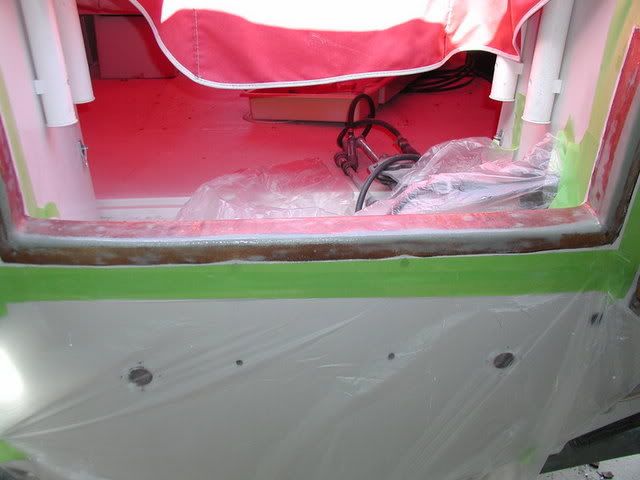

Holes were drilled in the top of the cap and all the wood that could be gotten to was treated with CPES.  CPES is an epoxy sealer like get rot.

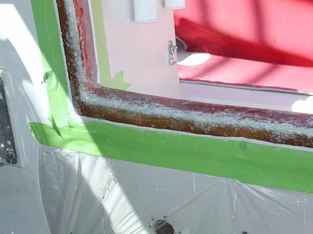

The opening was then filled with 1/4 inch chopped glass and epoxy resin to fill the void.
This was then sanded to a rounded shape as Stinky and Skools have told us.
I then refilled the small holes or any openings with a paste made from talc like powder and epoxy resin.
The cap was sanded and then wrapped with glass tape.  I used two layers of tape because it is not too thick.

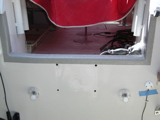

I then retaped the cap and applied a tinted talc paste with a paint brush.  The texture was acheived by using a plastic scouring pad.
Tape was removed before the texture coating was completely cured.  I'm pretty much satisfied with the project.  Time will tell!
