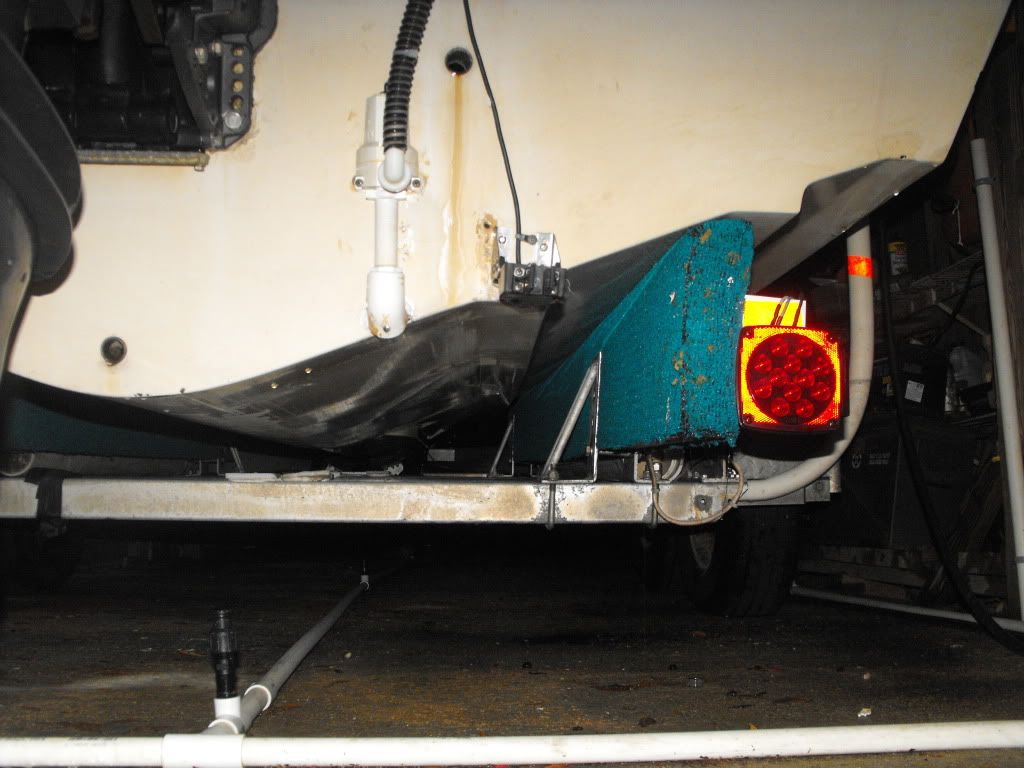

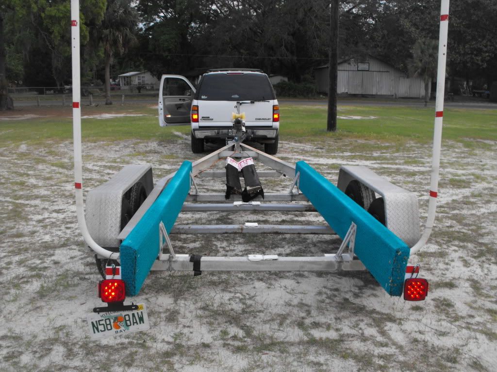

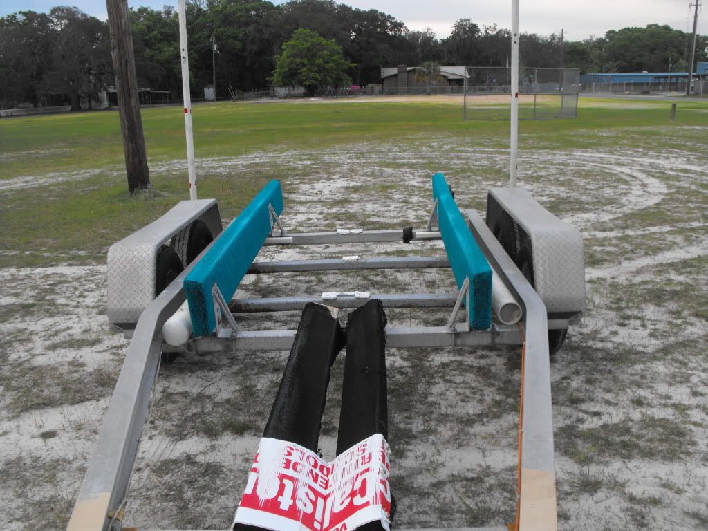

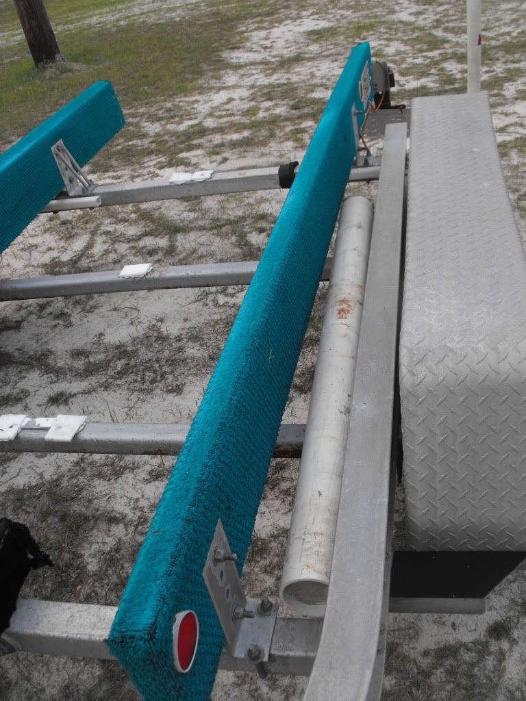

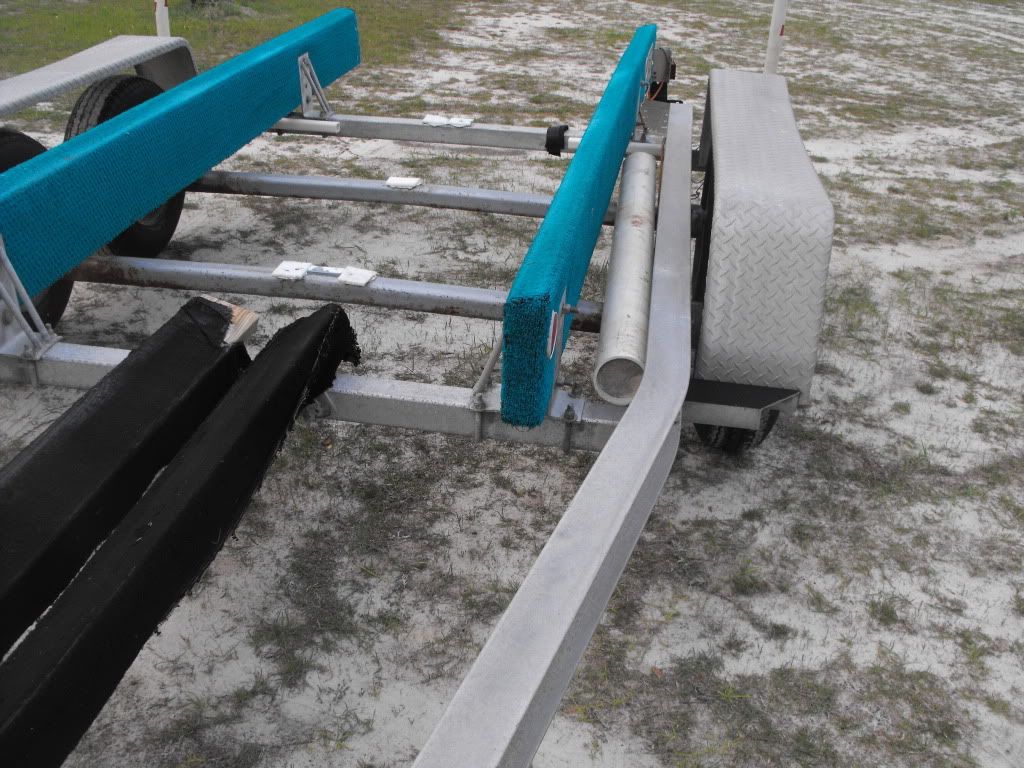

bill, i've got an 83 on a bunk style aluminum trailer, i could take some measurements of the bunk height ,length, & width, kinda get you in the ball park. let me know if it would help
Trailer bunker measurements
PHATDADDY, Thanks for the comeback. A few measurements would sure help. I plan on using the adjustable bolster brackets, as shown in Overtons cat., and once I transfer the boat, I can jack it up and make final adj.
the bunks are 50" apart and 11.5" above the horizonal frame member in the pic
the bunks are 2x10 rough cut cypress with a bevel at the top
if you need something else,let me know
