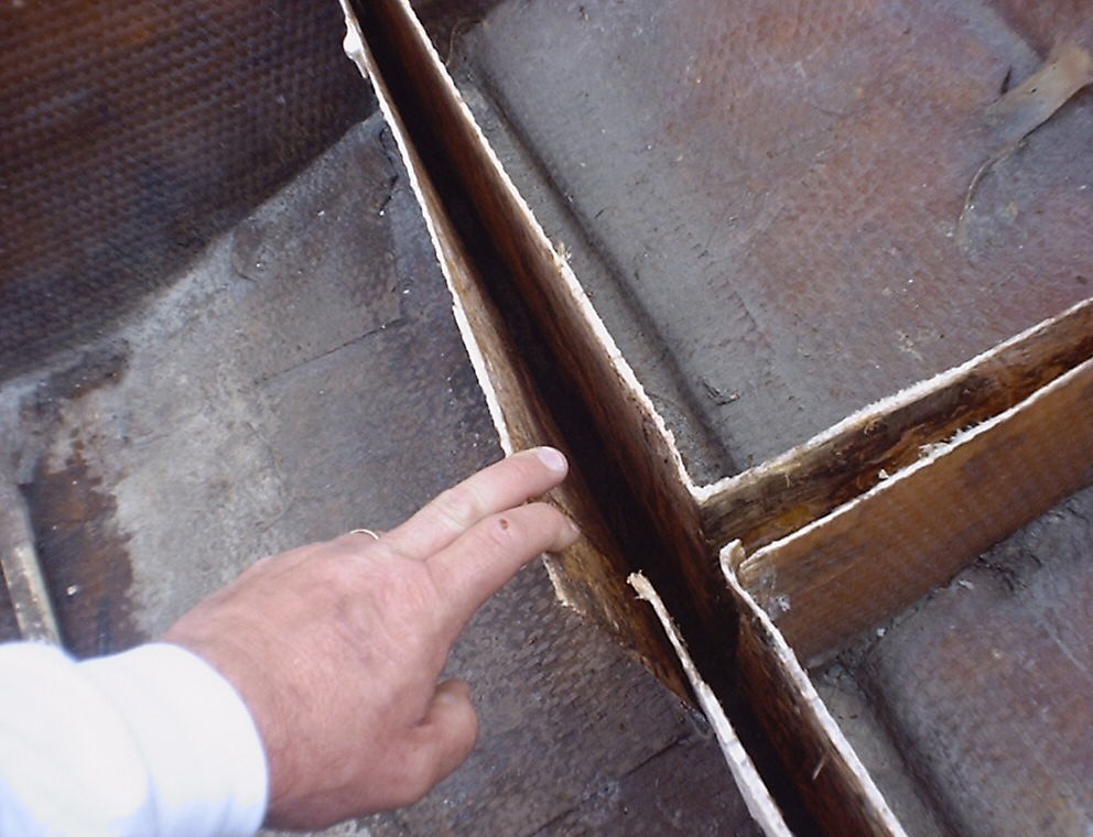

I used plywood w west system to rebuild the transom , in doing that I glassed in pvc pipe thru the limber holes. I was just curious as to how many stringer problems have come upEasy way to check for stringers issues is the limber holes. They are the holes in the stringer where it ties into the transom. When wellcraft built these hulls, they just drilled holes and left the exposed wood unsealed. Usually where rot begins.
If they would have sealed these holes and the top of the transom instead of that piece of magic waterproof aluminum,where the cap sits on the hull, a lot more of the boats would still be around.
