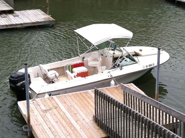

Look at my thread Gunnel Project. take a look at the spashwell. coveres the front part with starboard (reinforced with angle aluminum). can still raise motor. I mount a cooler there but a cushion would make a perfect seat. thinking about a removable backrest for it.
Here is what I did... Its 3/4 plywood cased in resin and painted with topside boat paint. The top is spray in bedliner, same as what I sprayed on the floor. The seats are a bass boat universal 3 piece set
just go buy the biggest cooler at academy sports and the cooler mounts for the floor and bam a new back seat thats a cooler. we had a upholstery guy make a cushion that snaps on and off. super easy
