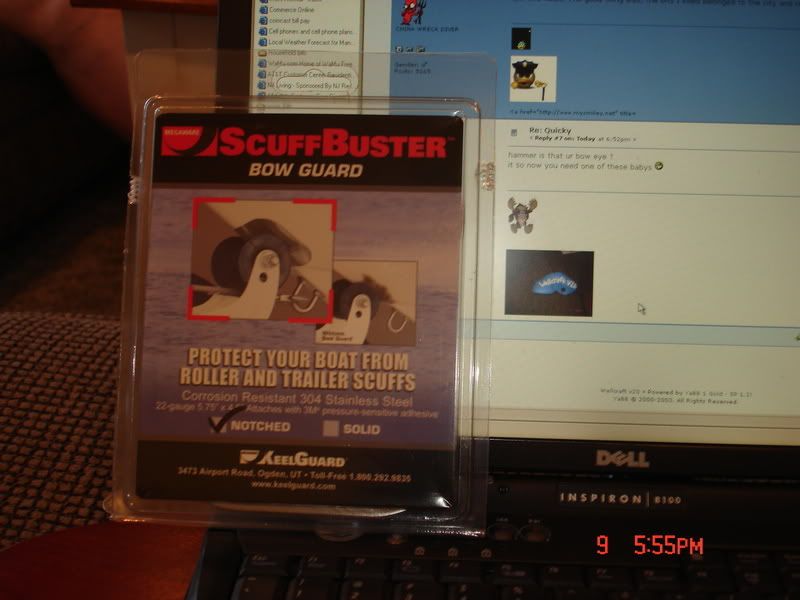

Hey Lumber, looking at your bow guard. So whats the differnce of having a knotched or solid one ??
Looking on E-Bay for one now.
If I don't look I don't worry!! but this is a repair that I need to do cause my eye is bent a little. :-/
