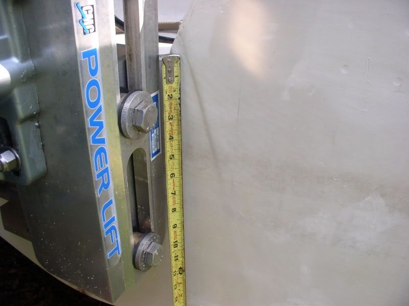

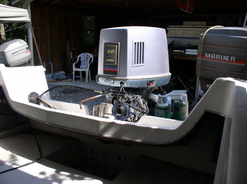

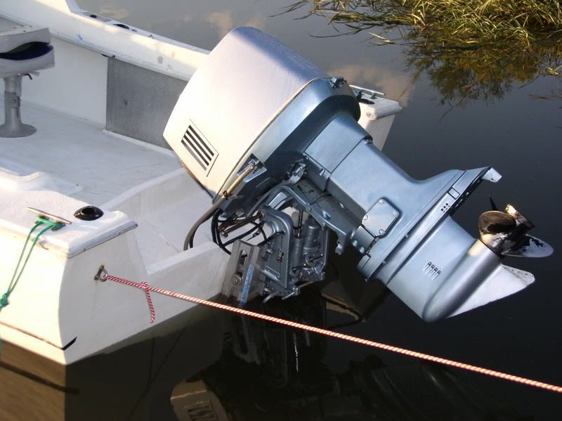

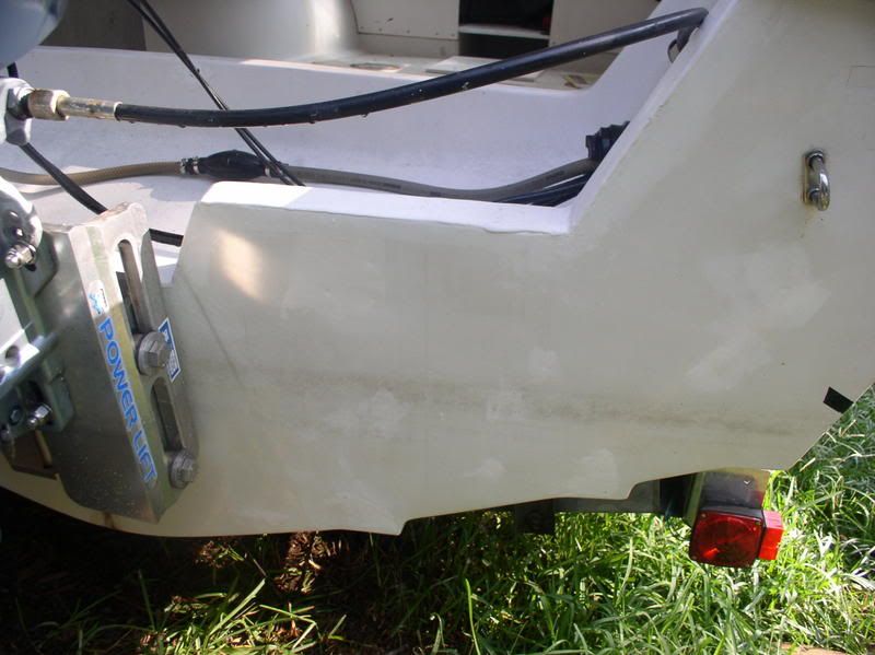

Hey Bigshrimpin, it's good to see another guy from my area on this board. I live in Modesto. I'm very impressed with your work. That is a great looking bracket. I was under the impression that most brackets were made out of aluminum or stainless. I am going up to the sportmans expo this weekend in Sac. to get some ideas and look at all the other goodies. Do you have any conerns about the strength of the bracket? I am well versed in wood work, (carpenter) and also have done my share of autobody work so a prodject like this would be feasable. Thanks for the photos, and once again, impressive work!
motor bracket
