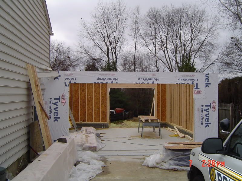

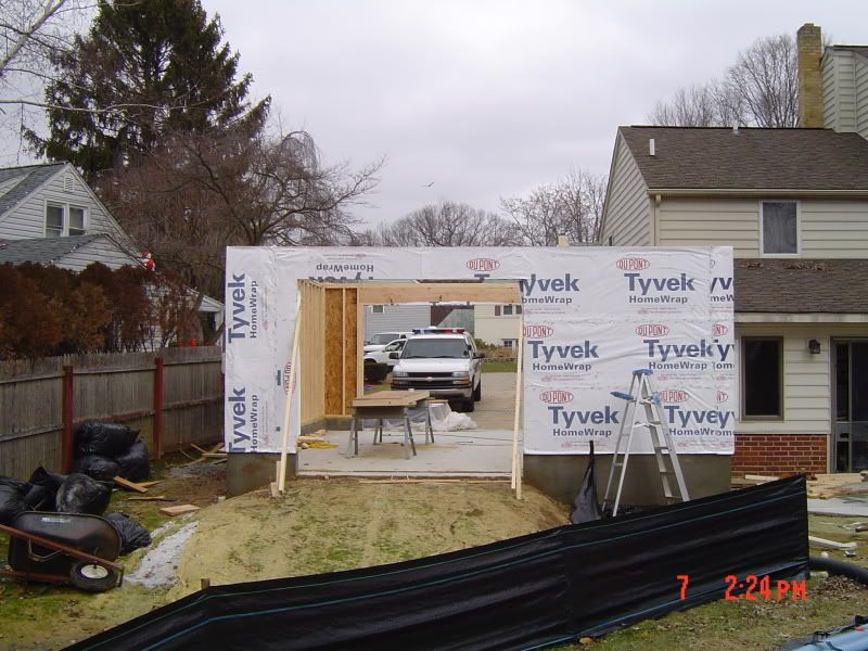

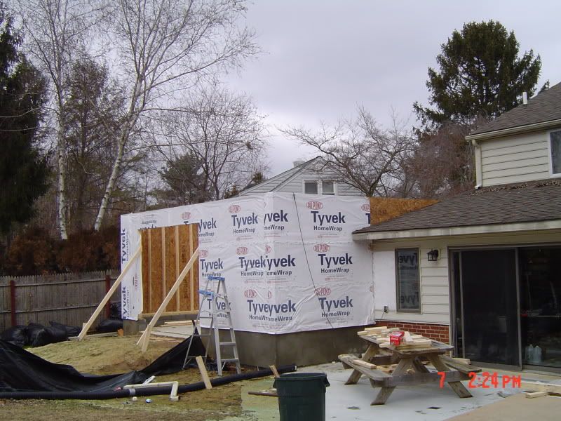

Was hoping to have more done. Figured I could left the walls myself, but soon realized that I'm no young buck no more. Had to call my cousin to help lift the walls in place. Even with two guys, the walls killed me.
Ceiling joist will be 2x12x24", not sure if thats easier then using 2x12x12, but I would have to stick in a center beam. Roof pitch will be a 6-12 pitch.

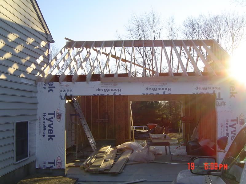

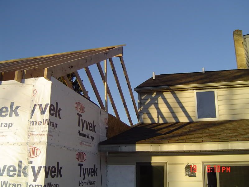

A few more Pics. Thought I could do this myself, but realized I needed help. Called in my two cousins to lay the ridge in. Roof Rafters were a pain as well. Alot of cutting. 36 rafters, with each rafter getting three differnt cuts.
Still need to adjust my height opening for the garage. The height is 8' 8". Need to pak the top down 8" I think.
