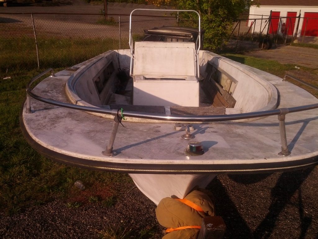

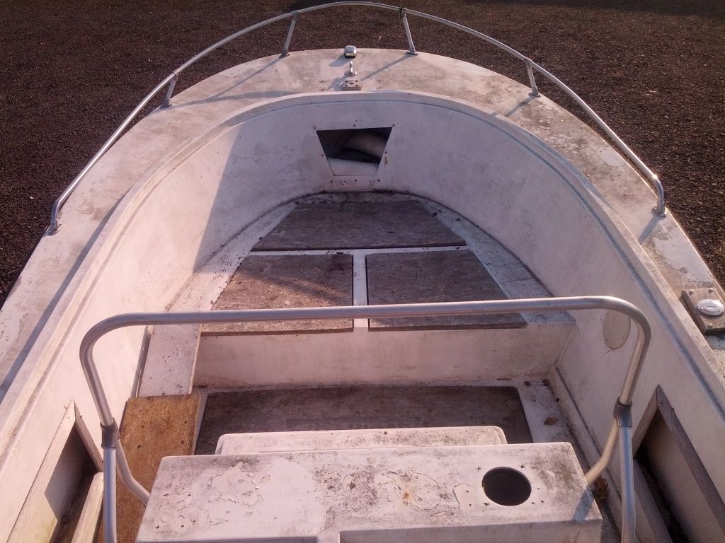

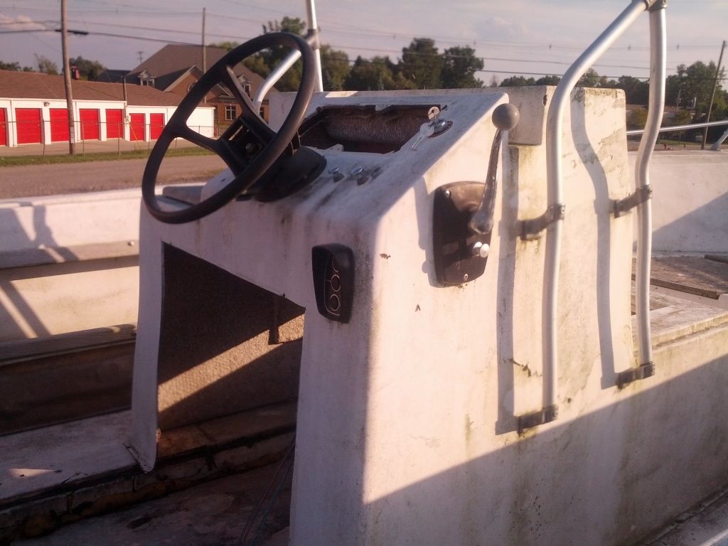

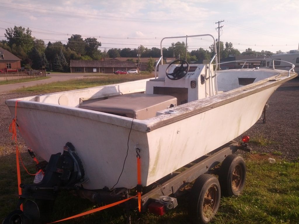

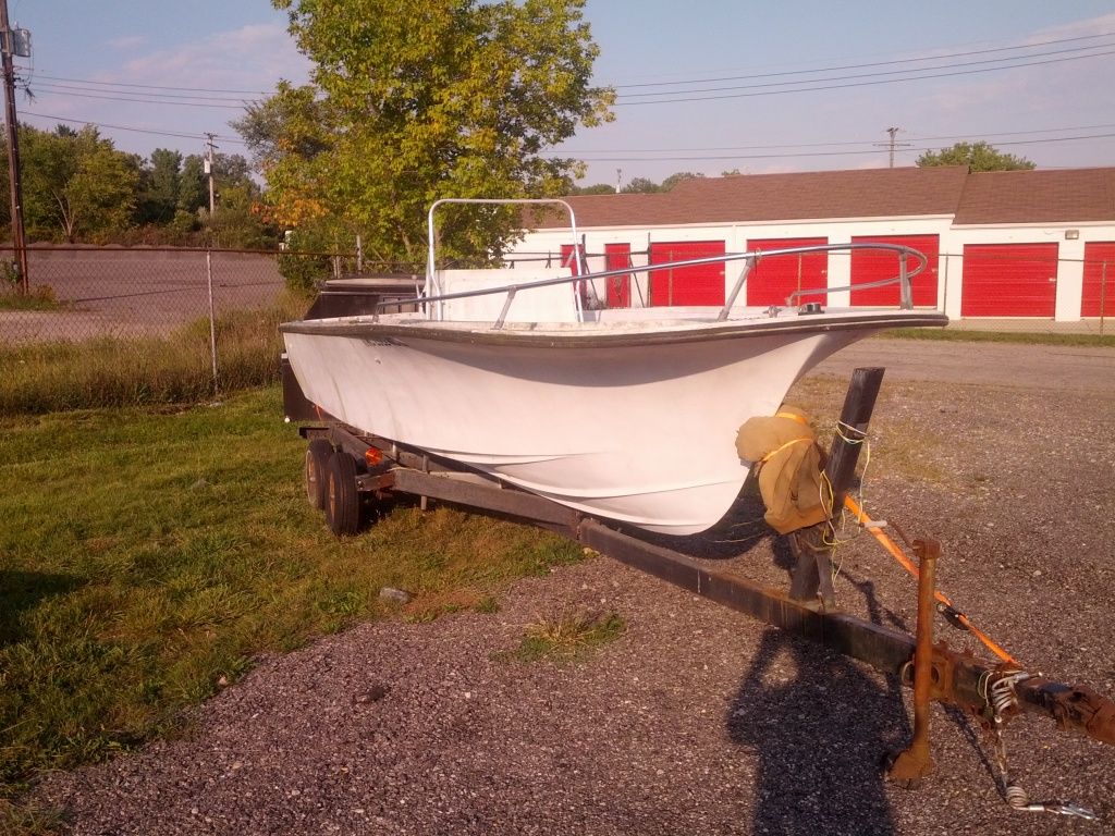

Well here she is the new to me Wellcraft V20, looks like early 70's
What do you guys think the vintage is. Has a 165 Merc I/O and new fuel tank. So i got that going for me. She is a little ruff around the edges.
Floors seem solid there is no hatch for the fuel tank,
Transome sounds good with a mallet. will drill some holes for further inspection. Time for the power washer to meet old boat.
So now where do I go from here. has rebuilt lower unit & new bellows. Engine has some water in it. Should I
go thru the old 250 or find a good freshwater 165 round here? howdo you tell the engine year?. Is there a serial number directory? Anybody have a good 165?
Is that the best power plant for her? I want it to be a solid fishing boat to runaround on the great lakes.

A i/o center console V20? Your kidding me right? That is a badass combo. Does the engine run? Look on the transom on the starboard side below the rubrail and there should be a hull identification number. Two of those numbers are the year. It will start with a 7. Yours is probably a 70s model it could be early 80s. What are your plans for the boat? Keep the motor or go to outboard? Welcome to wellcraftv20.com

Thanks Jason I was wondering it it came like this or was a a home-do job.
Looks like a tuna clipper with that high transom. The guys all said it was a MAKO. Title said it was a 20' 1972 Boston Whaler -

I saw this on ClassicMako site...are you sure its a V? The liner doesnt look right to me...early 70s liners were TOTALLY different and the deck where the rub rail is attactched at the bow doesnt look right either.
Dont get me wrong, it looks lik an awesome project...just have V-doubts.

Rite I was a little unsure too. Looked kinda like a Dusky but the front bow and the little chines are like a V with the wide front bow. Has small turn down on the rubrail. The inside looked like a MAKO inner tub.
I think it might be a Police boat from Bimini saw a similar one on the web.
So where are the experts around here? I guess I will have to go with V till we know more the hull looks like a V wonder if they took another CC & clipped the cabin off it.
And made some crazy lookin Dusky MAKO Whaler V carolina Allmand Skiff
Well anyway we can wait for the experts. The MAKO guys said it was a V20 so I am here for awhile. If you guys will have me = LOL :nut:

It has to be a Wellcraft V20. If it is not, then It was pulled from a V20 mold and another sticker slapped on it. Right now I have two tabs open and toggling between the pics of your boat and my boat, I can spot no differences in the strakes aka "steps", the only difference I see is your hull does not have such a curve in the rubrail line about midways. I am going by the outside hull only, not the cap.

That is what I was going by the chines in the bow the Hull is a V for sure, seems like the top has a few differences in the rubrail & no distinct midway rise.
Inner liner is no way from 70s...My '74 V has a totally different liner from my '79 and neither one is close. Console different also....
My personal opinion is that I have never seen a Mako with the much flair in the bow. It has to be a v20. There are definitly some mods done to the stern, you can tell by the way the rubrail comes to an imediate stop at the transom and does not return to the transom also the back exterior " transom rail" looks like its been glassed on. And also look at the way the cap/liner does that offset at the transom.
Union laker, look real close at the transom and in key places in the back and see if you can see where she's been glassed and faired maybe some imperfections in the glass work will tell a story.

Sure looks like a V-20 hull...and definately looks like a home made transom...to me anyway.
The 3 button trim switch is from the 70's.
