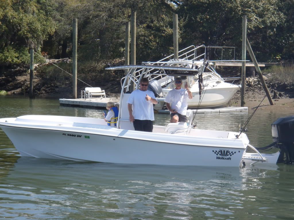

Welcome to the site by the way Chiefsurfer.....if you want a center console to aspire to following is a picture of our resident primo center console. Hopefully not offending any other center console owners but having seen it in person it is the baddest. (if that's a word)
Yeah it's almost hard to believe that boat started out life as a typical notched transom...Vic crafted that transom as you see it here and did all srt of additional fiberglass work...
and it ain't JUST purdy...it's FAST!!...:clap:

Thanks for the plug Reel. Welcome aboard Chiefsurfer. As a fellow center console owner I can say yours looks great in blue. I love Builder FL's center console, maybe my favorite, next would be Ben Fishin with his tower boat. I wish I had pics of my RueGoldberg molds I made for the rebuild.
