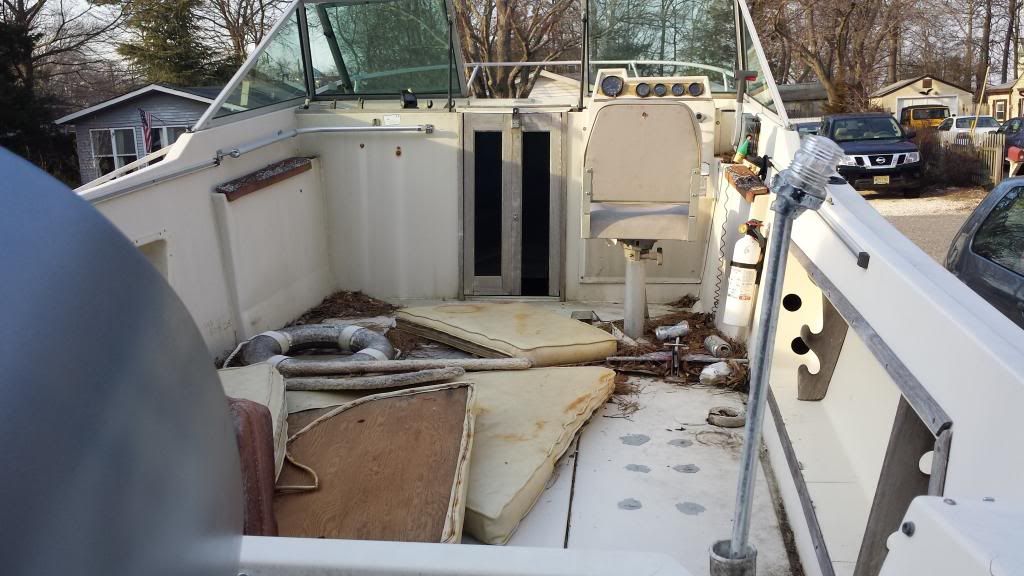

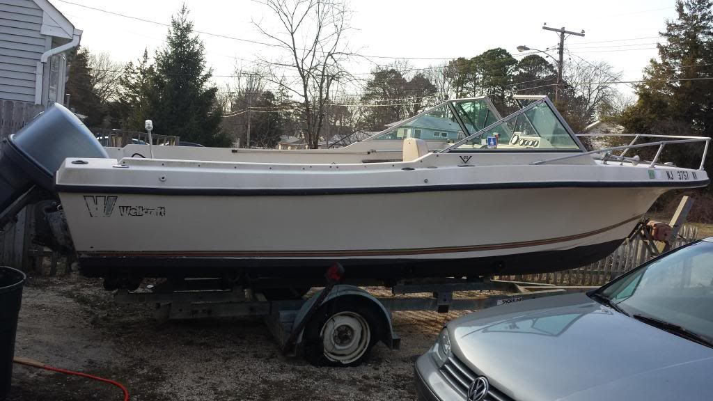

anyways i have recently purchased a '79 wellcraft v20 cuddy with an '85 yamaha precision blend 150 outboard. the boat needs a few things but it's the first vessel that i have ever owned and feel as though i got a good deal ($50 with trailer). boat seems solid but the under deck fuel tank is not being used (6 gal portable fuel tank on board). also there is premixed 2 stroke gas in the tank (which worries me; i'd like to have the precision blend system working, even though i am not familiar with it. i do have vro experience though. seats are missing on the boat and it looks like someone tried to patch bolt holes on the cockpit deck (poorly). paint is faded and wiring is super messy, but its nothing that can't be fixed. there are no electronics on the boat. tried to fire the yammie up yesterday after installing a good battery and it has stale gas so i'll need to rebuild the carbs before i can update on how it runs, but it will fire on starting fluid (i know not the best idea but i wanted to know if i rebuilt the carbs that it would run). the tilt support lever is also rusted up so i can't use it. plus i had a trailer tire blowout on her maiden (trailered) voyage home.
I'm happy to be a member of the site. i've been browsing around and it seems as there is a wealth of knowledge on this site. it's nice to see reference pictures of completed boats, because mine is missing seats and all kinds of stuff. thanks for having me, guys. on to the pics.
For $50 you got a steal. First things first... welcome to the site! Happy you found us!! Since there are so many different things you just mentioned I will suggest that you DO NOT try to do everything at once. Take small steps.. do one project at a time. First, check the transom and the floor for soft spots. If they pass then clean it so you're not working in dirt with every repair. If it were me I'd check out the tank first, and once that's clean and I knew it wasn't leaking then I'd go to the wiring, then the engine. Once the major things are up and working like they should, I'd start on the cosmetics, like the floor holes, seats, etc. Get the majors done first. Just don't lose heart. You have a lot of work in front of you, but in the end you'll have one of the best damn boats in it's size that's ever been made, and you'll turn heads everyplace you go.
thanks man, i appreciate it. after seeing all the posts on bad stringers and transoms, i'm terrified to check them. i'm going to do all the mechanical stuff first then worry about making it pretty. i was just going to buy and sell it but i brought me 13 month old daughter aboard to see it. i sat her in the helm on my lap and she was laughing and playing with the controls and steering. at that point i decided i should give her the same nautical experience i had as a child (my girlfriend is not as happy about me keeping the boat as i am, seeing as how it needs so much work/money). but the first time i take them tubing in the bay i'm sure she will see it differently. :sly:
