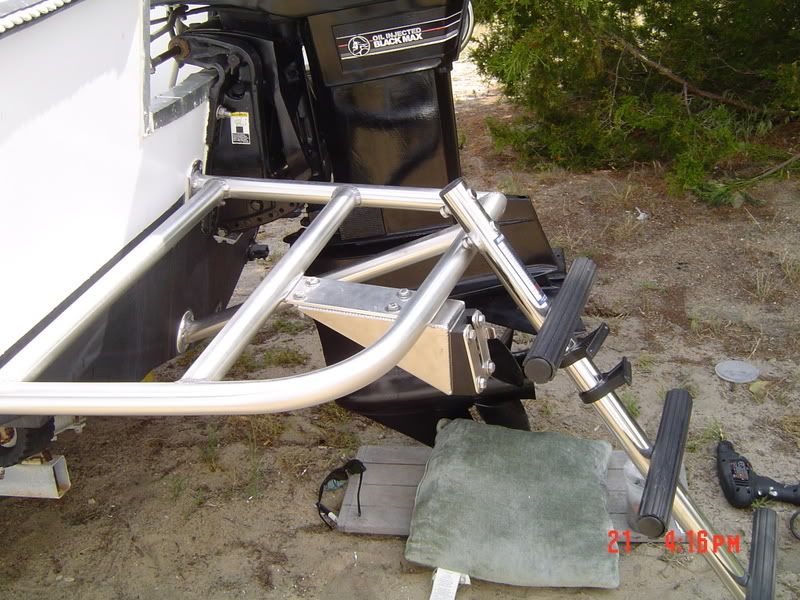

Dive ladder bracket.
Mounted the black piece the wrong way. Didnt realize it until it was bolted onto the platform. I then couldnt undo the bolts, so i had to cut two off and redo. >:(

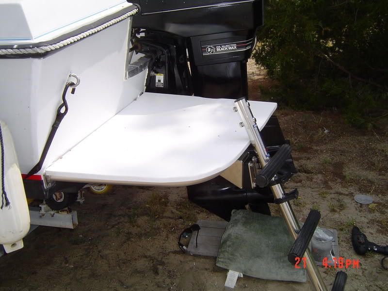

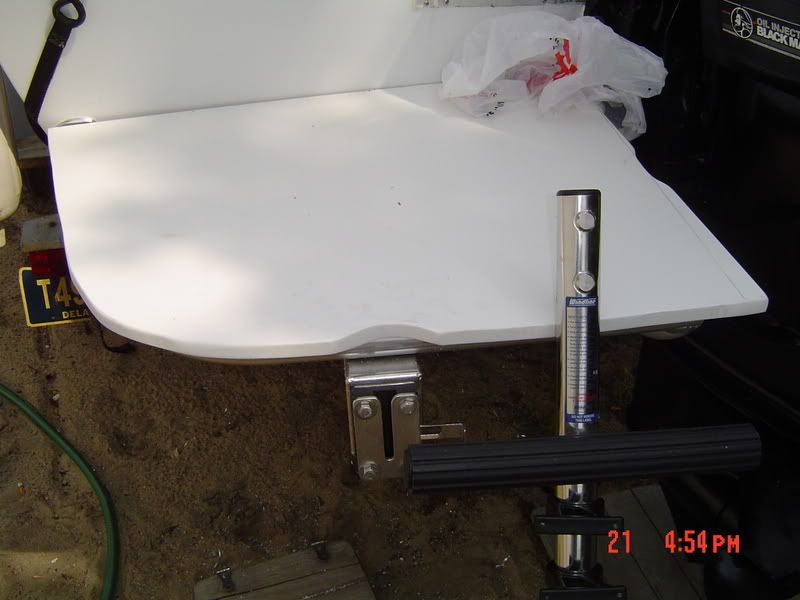

Bracket mounted on the platform.
Hmm, do I or Dont I like it. :-/
Jig saw time. ;D Hoping it will look better when I get a router and do the edge. Somebody UPS me a router. ;D

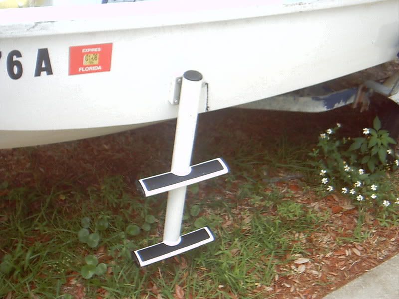

hammer, hopeyou have better luck with that type of ladder than i did. good idea, but the plastic steps did not hold up, especially with 200 lb divers & 50 lb of gear. when the plastic breaks off there are some wicked steps made out of metal with sharp teeth that point up so you can step on them. save some starboard to make some replacements. i went with the garlick style

Can you reposition the ladders mounting bolts to use the top of the ladder as a handle or you think it will get in the way? Naaah it will get in the way. ;)
Cut hand holes in the Starboard or add a handle to the rear of the boat?
