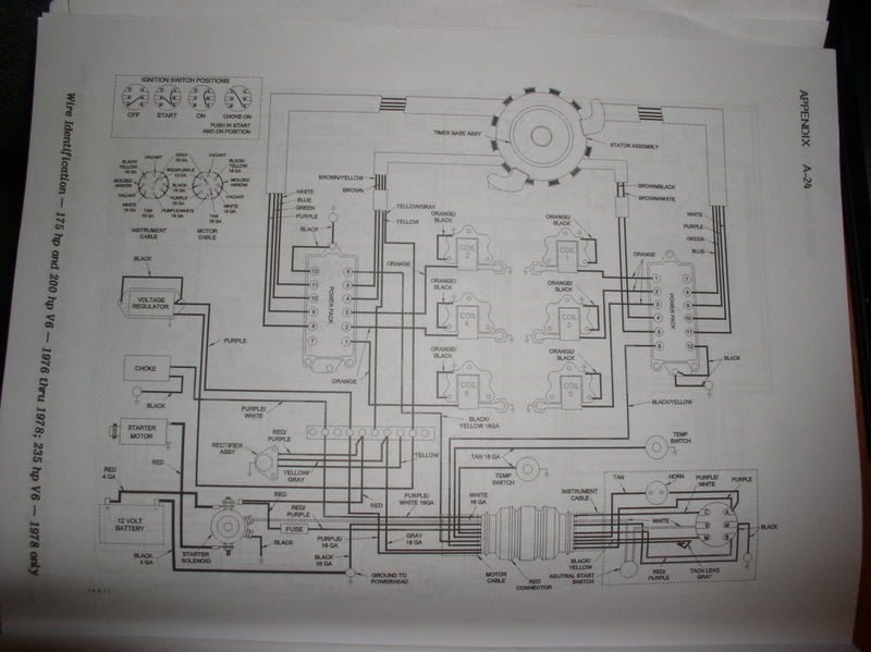

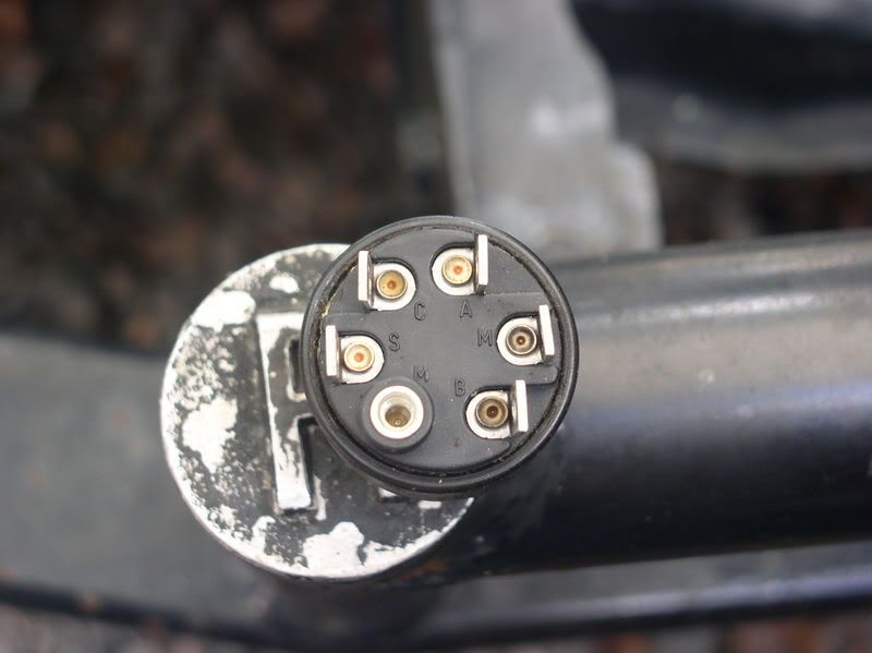

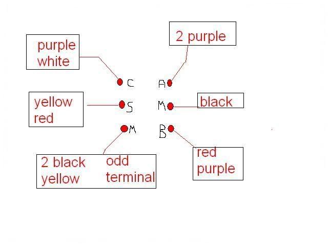

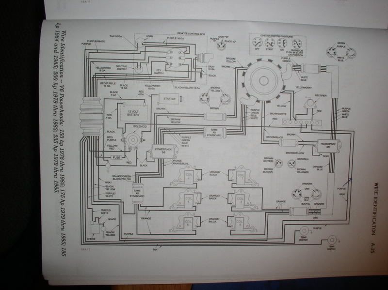

NE1 have a diagram of the round omc ignition switch so I can test voltages coming off the switch?
