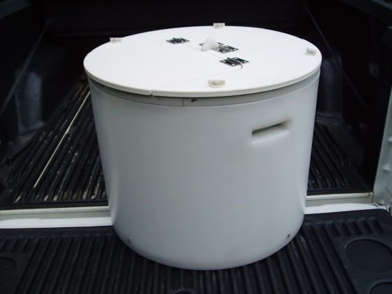

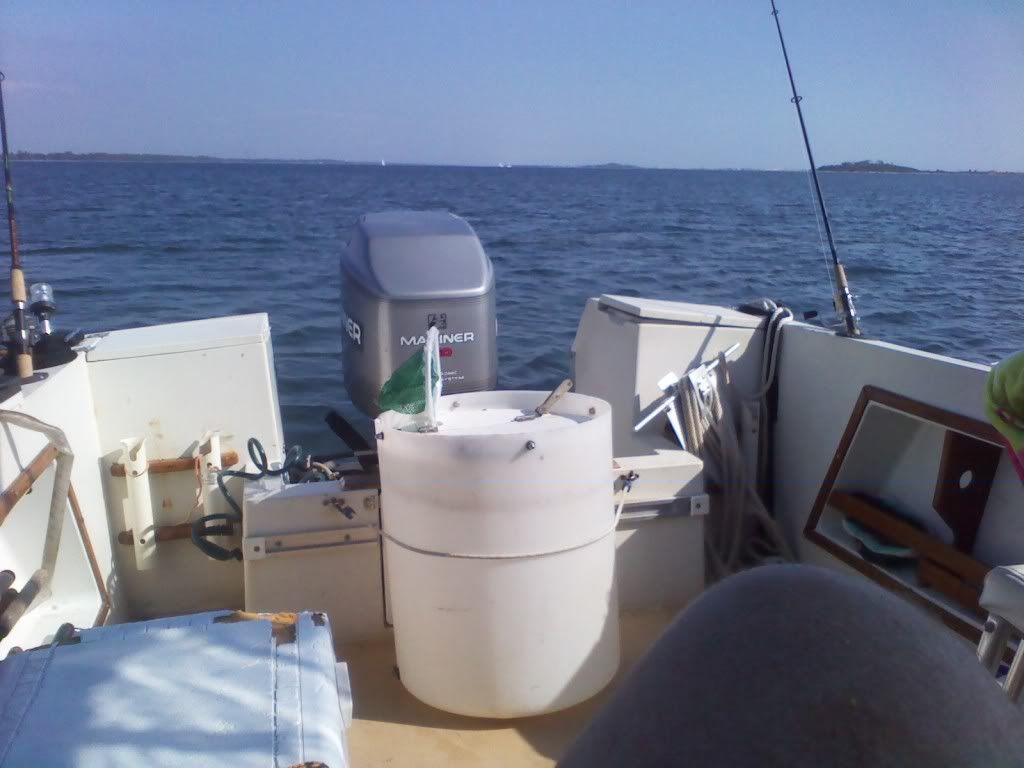

I bought a separately purchased live well tank and used that with a overflow hose that went into the motor well area. It worked great.
