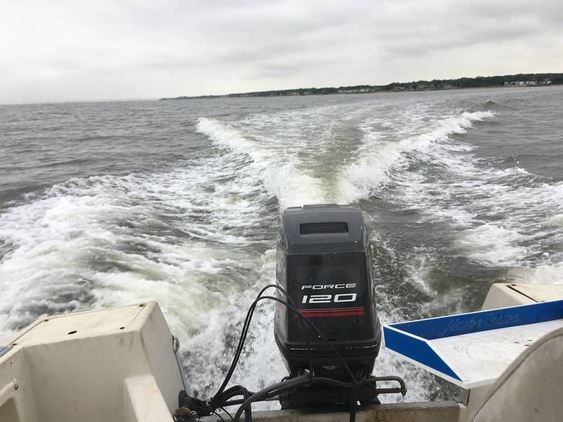

Would I put a 120 on my boat? NO, not for a second. (Well, that's not quite true... if you look at my signature you'll see that I have a 120 Force on my Wellcraft Airslot. It's a good engine, but remember that my Airslot is only 16.5 foot long). Would I hang one on my V21? No, I would consider it way too underpowered. For me, the least I would use is a 150HP. (With the exception of the Suzuki 140 that thinks it's a 150) :head:
Pic is of the 120 Force pushing my Airslot.
