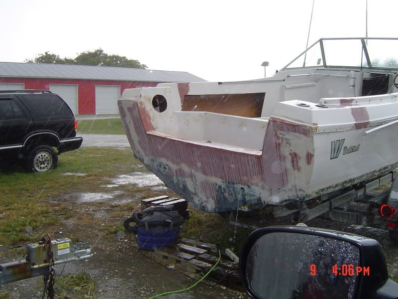

Nothing new in my life except spending a little bit of time everyday trying to get the transom done. She is thick as hell and just about got her straight as best could be.

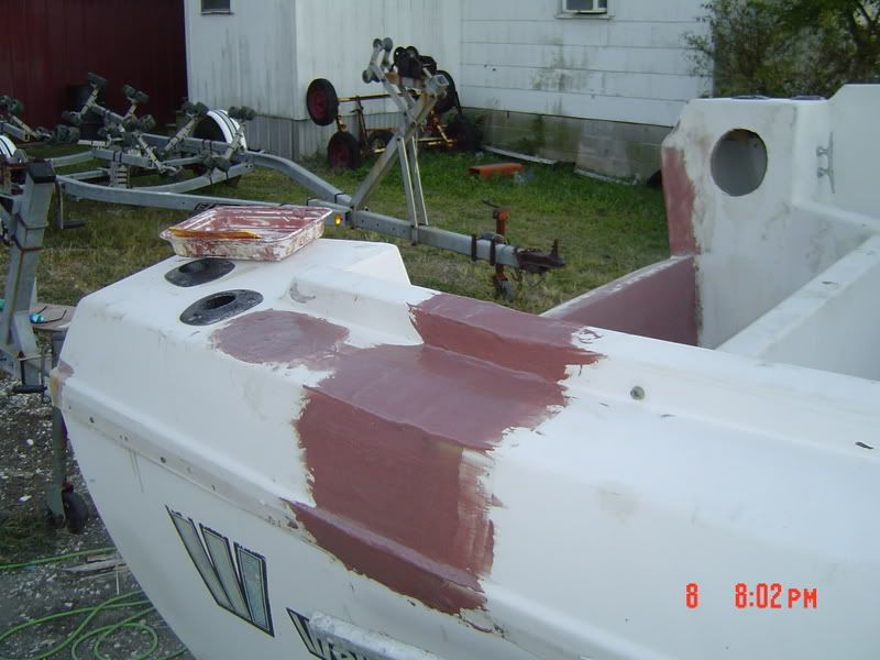

Glassing the sides in. Hoping the faring isnt as tuff as the bondo, glass resinn. Gonna sand her down and hoping on two coats of fairing, sanding and then primer. Thats it for the transon till I decide about paint.
Wanna start on the fuel hatch cover or teh soft spot in the deck.
Damm !!, Just noticed that high spot on the corner. >:(

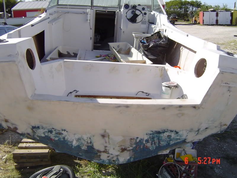

Well guys, I was at it again tonight working under a spotlight doing some fairing. Temps were a bit lower and some high wind. Had trouble with the West System 410 Fairing. Was taking forever to kick. Not to impressed with what I did. I see alot more sanding in the morning. This Fairing stuff seems like nothing more then High dollar wall spackling. But I havent given up yet. I did have to sell off one of my kids though.  ;D

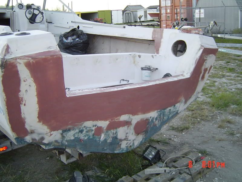

Looks the same as before, but this is 45 bucks of West System I'm sanding on. Fearing seems to take time and patience...that I dont have. >:(
Hammer - If you ever have to do this again . . . systemsIII quickfair is a 2 part epoxy fairing compound that is all lready mixed in with the cabosil/microballons/qcell etc . . . so you keep the pin holes to a minimum and it spreads on like butta and hardens like a rock.
Get that fairing board and sanding block ready cause you're about to do some serious sanding to get that all straight again.

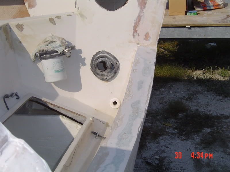

Borrowed a straight air sander that SKOOL memtioned. Should get her alot straighter. Cant wait to get her done so I can move on to cutting out the soft spot in the deck and replace the fuel hatch cover.
More sanding on Sunday. ;D
What a learning experience. ;)
Hamer, Try using a longer stiffer fairing knife to get a straighter finish. I use dry wall mud knives from lowes they are cheap and work great (Get atleast two).If you work careful you will have very little sanding. Hold the knife vertical while dragging across the surface so the blade won't bend and the end result will be much straighter. Make sure that any roughness is removed before applying the fairing so as to end up with a straight, smooth finish.
