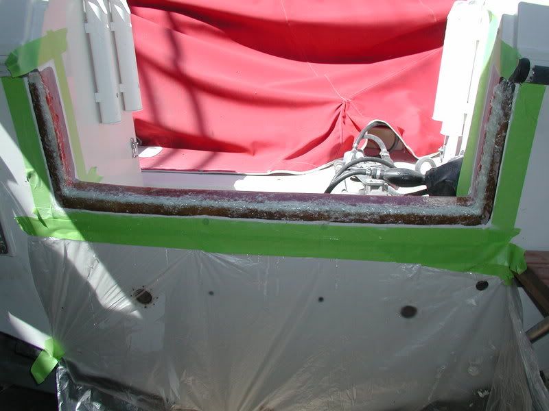

I have Stinky's choice, I'd like to have yours.  I'm going to glass over my transom cap like Stinky did.  What is easier to use and is there a difference in how they bond.  Mat material (randomly spread fibers) or the woven type.  Here is a picture of the gap I will be covering.  Any other knowledge is wanted too, ex. how far to grind back etc.  Thanks Billy Mac
These two photos show the transom cap before the Motor was removed.
Here is the transom minus the motor and all of the plastic cap cover.
This shows the gap that is there.  the filler is being removed.  On the left you can see the old filler.
This show Dan using a Dewalt model of a roto zip to clean out the old filler
I've taped it off where I will sand down the gel coat to bare fiber glass.
I forgot to take a photo of it sanded down because I wanted to get home to see the Red Wings game, but we sanded it down and then squirted acetone into the holes and cracks to displace any water.
Wood in transom treated with CPES. Someting like get rot. Wood was firm but still treated it before sealing cap.
Gap filled with 1/4 inch chopped fiberglass.

I would get any lose stuff out of there, then grind all gel coat 3 inches away from the infected area, I would use something like formula 27 as a filler, then cloth and resin to seal, sand then paint.
But I would be asking Stink, skools since they have already done it.

Pictures will follow for sure. What Wellcraft did on mine was to seal the void between the liner and hull with a resin and filler mix. Though the years this seal cracked and opened up about 1/4 inch.

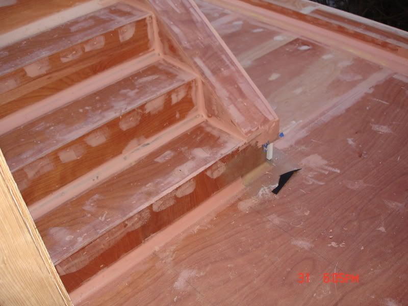

Have any of you used Bondo to fill in voids ?? Then glass over that ?? A friend told me that yesterday and i find that hard to believe. He said Marine Tex and Bondo are identical except Marine Tex has fibers in it to make it a little stronger. Any truth ?? Didnt mean to derail this thread.
Scott
Parrot the guy at our fiberglass shop said you can use Bondo to fill.  At work we have a composite dept, the guy there recomended using the epoxy resin with chopped fiber glass fiber for a little more strength along with the hardener.  The strength here comes from the resin and matting, right Stinky, Skools?

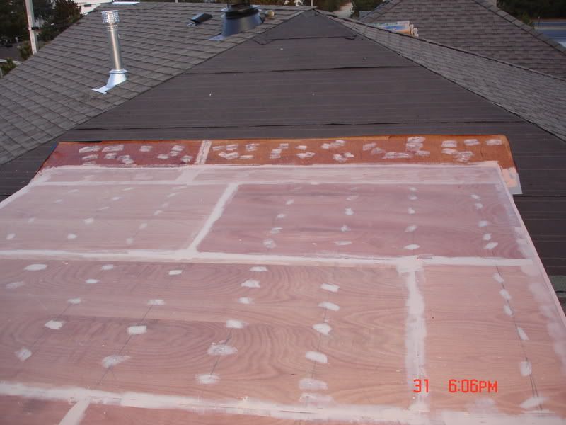

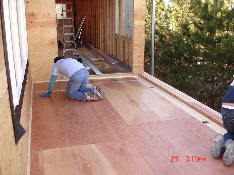

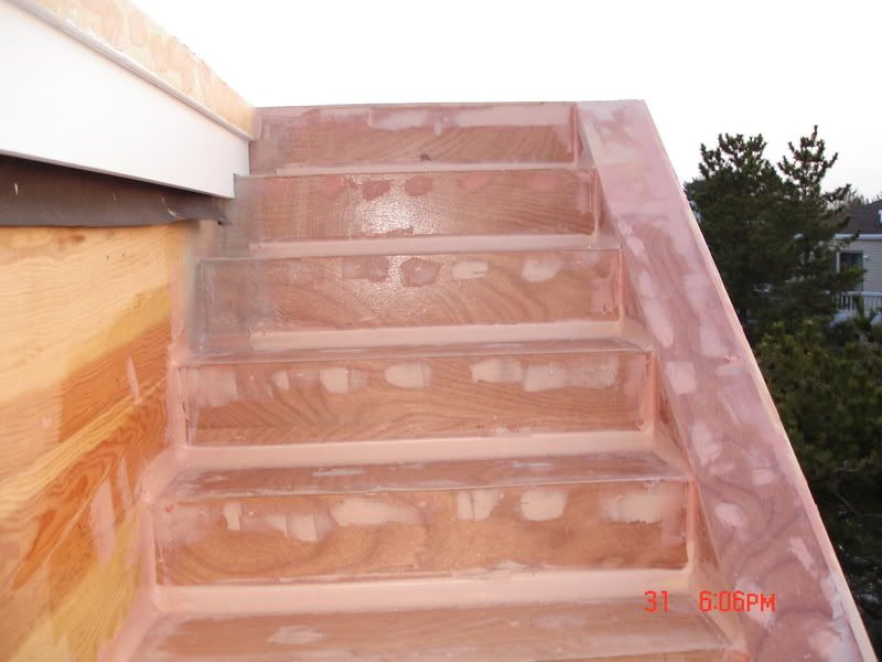

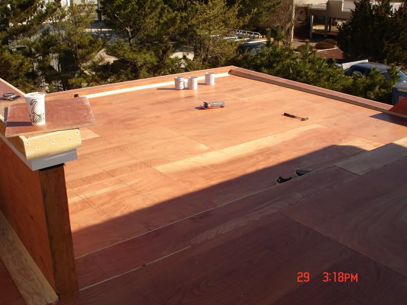

parrot , your friend is 100% rite , here on lbi we fiberglass our decks on these houses we build and they use bondo before they glass works like a champ....
these guys are doing bondo on all the seams in the plywood and nail holes,,,,, take note that all this plywood is pre coated with a fiberglass resin before its laid and theses guys get about 10 to 12 dollars a square foot to do this...... this house had about 25,000.00 dollars worth of glass work done.
