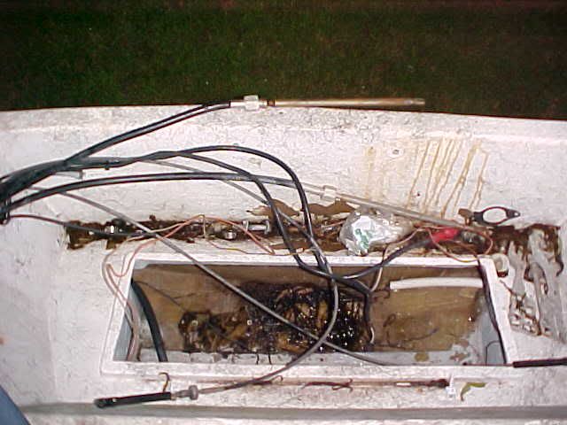

mine has a hole cut out in the motor well and has a lid but took off to restore the boat but had a Starboard lid see pic. There is a board in the bottom of the hole to hold 2 large marine battery's.

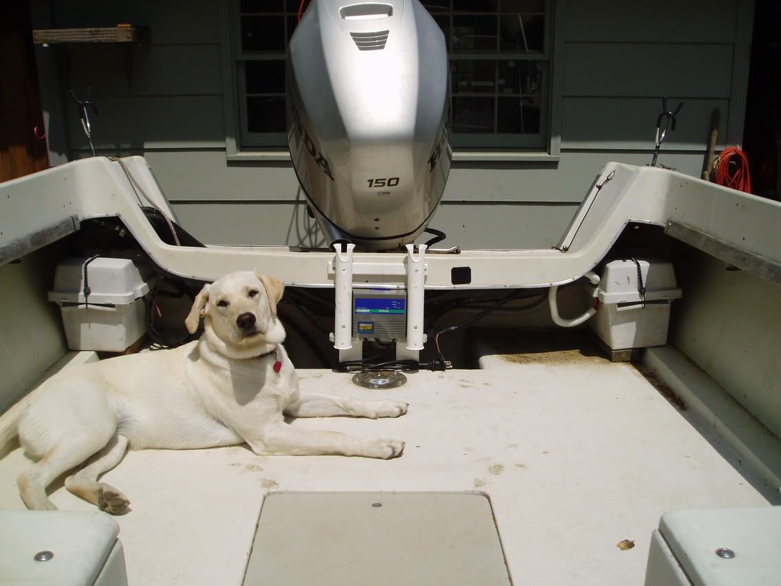

Here's how I did mine...
they're fairly snug in there to begin with, so all I had to do was put a hook-eyeinto the transom behind the batterys and a short bungee from that to the front of the box...easy in/out...easy's good...
Oh and the 2x4 spacers under one side of the bottom of each box...screwed to the box, not to the boat...slides right out...
And the most important thing is security...notice the Norton Snaggers over each battery...keeps out unwanted intruders when the dog's not around to lick 'em to death!! :o...

Franco, as always, is on the mark...the main reason I went w/boxes was to avoid shorting the posts...when that happens, POOP-CREEK is just ahead :o...also, knowing these batteries would be visually exposed, they needed to have a halfway decent appearance, so white boxes filled the bill (they really were white)... ;) :)...
In pic above, that's the onboard battery charger between the two rod-holders...so when they do get to go out the driveway, both batts are HOT-TO-GO...plug in and FORGET...plus, I'm conviced these computerized marvels greatly prolong the service life of a battery as they keep the batt at MAX charge... ;)...
