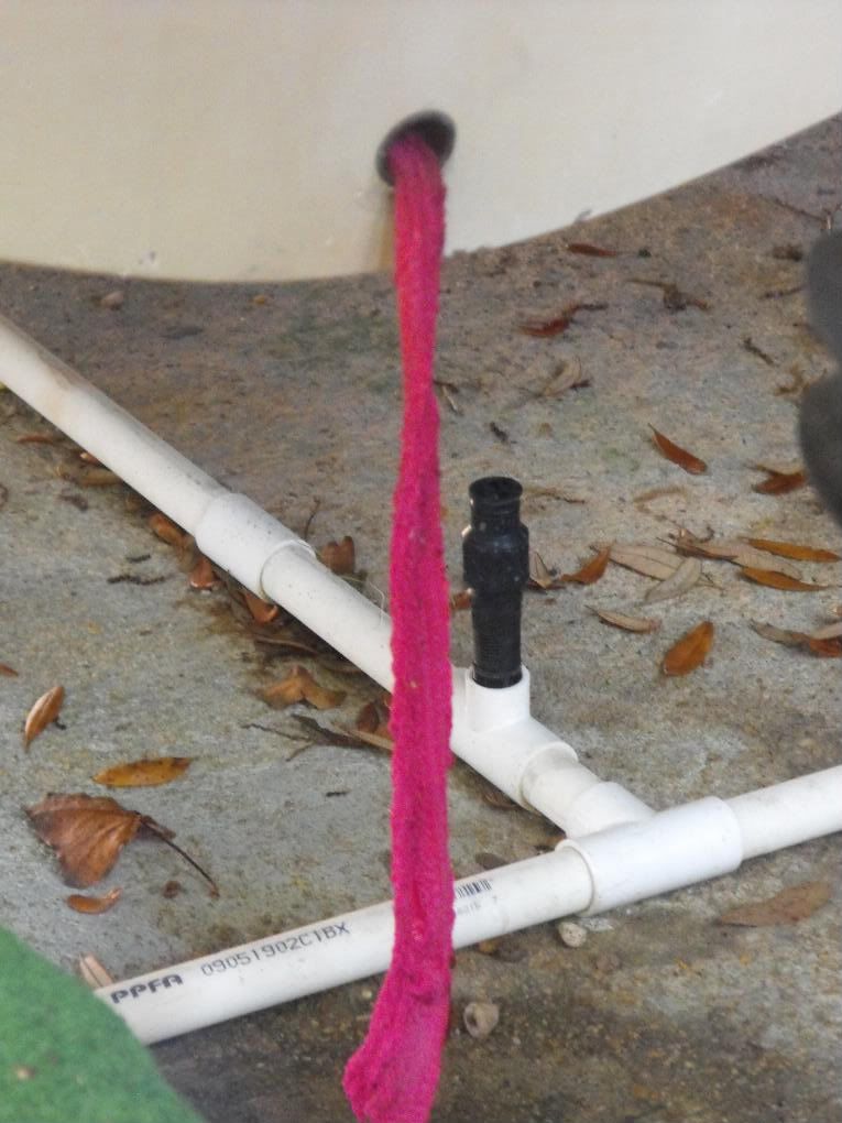

There was a post from someone a long way back that use to put a small rag in the drain hole and leave it hanging out so it would wick away the water and he said the bildge would be bone dry!

rkc, have the same concerns as you, this is my solution, and the bilge "tampon" really works well

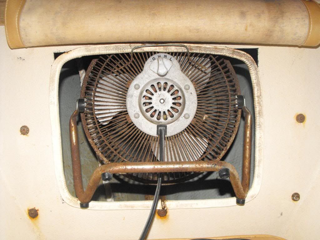

i also have a small fan i put in the cabin in the hole to the anchor locker and let it run all the time to air out the bilge.

I tried the tampon idea it works well, what kind of fan do you use?
