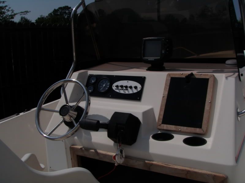

kinda hard to see, but I made this dash with black plexi, I cut out all th holes and made the screw holes before I peeled the paper off. Then i sanded the edges smooth, ran across the edges with a propane torch(it work real good) to give it that finished look. I painted teh back side with black paint to make it look better
