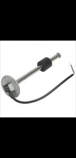

Does anyone know what length fuel sender I need for a 82 v20 cuddy with the 60 gallon aluminum tank? I'd pull the old sender and measure it but the previous owner has put 5 different types of bolts in to hold the sender and they look like they are going to snap off into the tank. I'm still using the boat. I will be replacing it with the type shown in the picture. All my boats have this type ofScreenshot_20181007-070730_Gallery.jpg sender and I've never had one go out yet.

I m seeing the sender, but cant help on the length.
There should be a post in the links section with the tank dimensions. You can get the depth from that
Or call RDS in Perry fl and order one
Like Phatdaddy I can see the float sender that you want to install, but I have no idea unfortunately on the length. I like that type of sender.. simple, pretty accurate, reliable.
I installed one in my boat but cannot remember what the length was. The aluminum original tank is 11.5 inches at it's deepest point(which is where the sender is installed). I believe I bought the 11" length but wouldn't swear on it. Whatever length I did use, the gauge was pretty accurate.
Edit: I did find the receipt and it was in fact the 11" model I installed. Worked perfectly. Check the links section . I just uploaded the tank specs for you to look at. Hope this helped.

Thank you very much!!

That is for the old type floating arm. The type he is putting in is the straight arm that the float slides up and down on. No adjustments necessary or possible even if you wanted to. I installed one in my boat and it worked perfectly.
just a reminder... its a belly tank with a V shaped bottom. It will never read accurately because the bottom third of the tank holds less than the the top.
