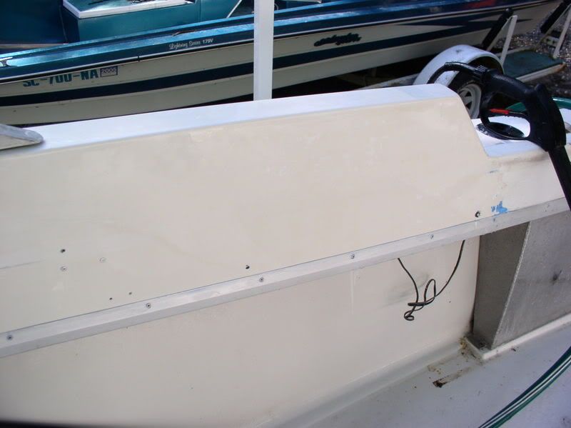

I'm still in the process of removeing old paint both properly and improperly installed on the upper deck. I'm having to use stripper and then sometimes watersand with sanding blocks and then buff with compound till it shines and then cover with wax to maintain some long term gloss.

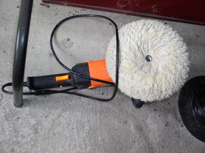

Don't use any sanding stuff (grinders etc), just buy a cheap buffer (Harbor Freight etc) and get some good grade buffing compound and polish most likely from a professional auto body supply shop. Store chains usually don't carry real compound but what they got will work on very slightly oxidised coats.
Experiment on flat easy surfaces till you get the feel of it and shine desired.

That was the whole purpose of me removeing the paint so as to be able to repaint. However upon doing so and asking a couple of former owners about it, come to find out it was easier to paint instead of cleaning the gelcoat from being stained so severly. ??? ??? was my responce.
Yes that is the coarsest I could find. And I suggest useing caution if you have never used a buffer to any great extent. I painted automobiles for 5 years out of high school.
In my case, the boat hasen't been washed in at least 5 years, much less waxed.
You may not need as coarse a compound as what I got.

When you use compound with a buffer, do you have to apply with a foam pad on the buffer, wait for it to glaze dry and then remove and polish with a bonnet? Or can you apply and buff all at once with a bonnetor foam pad? As you can see, I did not paint cars for 5 years out of high school. I am agreeing with the suggestions to use polyglow or Vertglas, but I still have to get rid of the layer of chaulky oxidation first.

if ur gonna buff, be carefull. buffing compound is liquid sandpaper. so wrrk in stages like sanding. working ur way up to a fine grit polish. use a spur or screw driver to keep ur pad clean. what you are worried when buffing is burning the finish. this comes from going to slow, dirty bonnet, or rolling onto the edge. it is exactly what it sounds like. buffer will build up heat and burn the finish. be extra careful on edges. make sure to position the buffer so that as it turns it 'rolls off' the edge.
and wear an apron and move ur wifes car far away. when you think you got it far enough, move it a little farther.

When buffing we used to get in a metal gallon bucket of compound and knock a hole in it about 2" round so as to be able to put a paint paddle in it. With the paint paddle we would smear or slap the car, dotting the compound around the area to be buffed.
The newer stuff you can scoot out the bottle on the area but the best way is to apply an even coat with a rag across the location to be buffed.
Buff immediately and when thru wipe off with a clean wrag and then start with the polish.
You must polish after buffing, the area is basically virgin and will hold stains easily.
