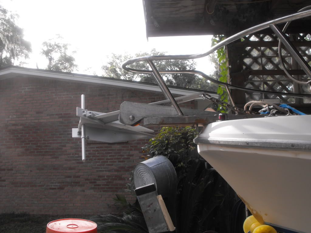

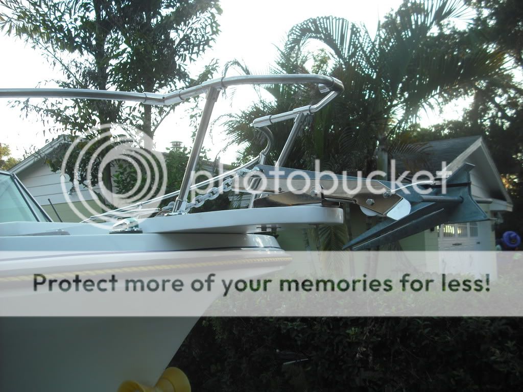

these are some shots of what i did. works great, anchor easy to let out and retrieve. the inside shot is where the deck pipe feeds the line to the locker under the self in the cabin. also shows the backing plate for the pulpit.

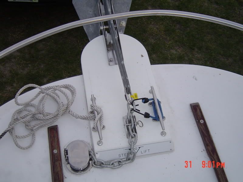

I built mine back in 2010 base on ideas posted previously on this site. Works great and is out of the way at all times. Notice the tie straps? Use it when freeway, extra level of security.....
CB and I made one for my V20 out of starboard, it was great!!
WOW!! he had hair and I was fat!!LOL Now its the other way around!
MJ thats a very simple yet awesome idea. I have scrap 3/4 starboard and will be building one like that to mount my anchor roller on.
