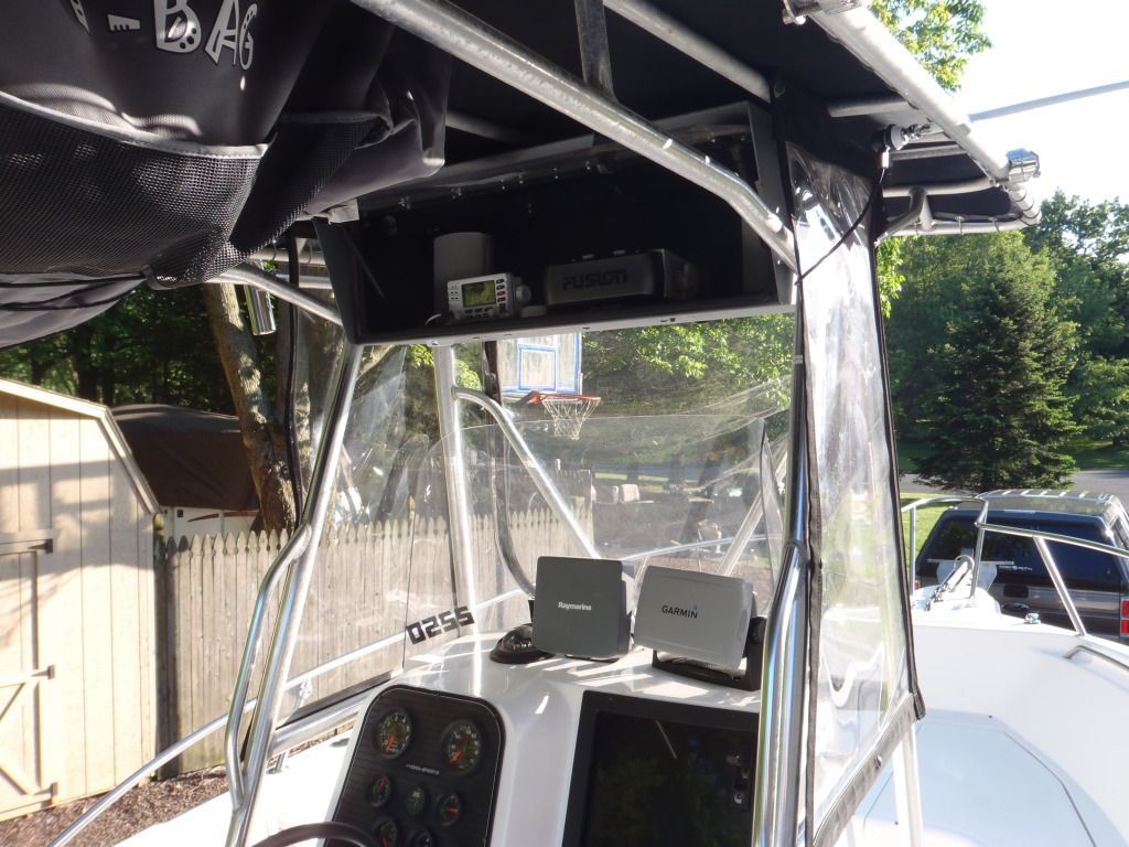

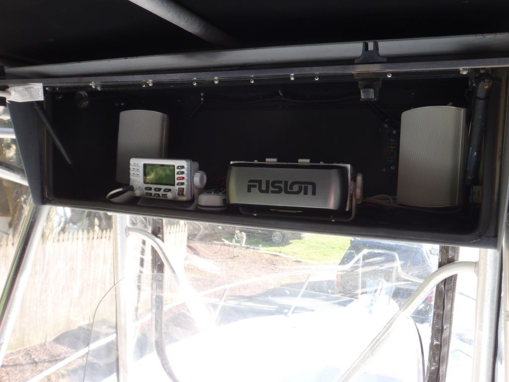

Got myself a nice Standard Horizon VHF with DSC, got my MMSI # and now I have got my VHF talking with my seven inch screen Garmin GPS so I can yell for help when needed quick.
Also installed a nice new Guest dual battery charger inside the CC.
And since I can't sing to save my life I went and splurged on a nice Fusion stereo and speakers for FB.

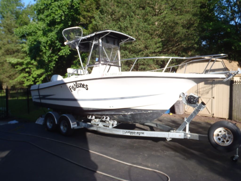

I do have to redo the bottom paint yet but basically I have a 1997/2012 HydraSport 2250 Vector and the maiden voyage is tomorrow with the CEO and one of my sons and daughters.

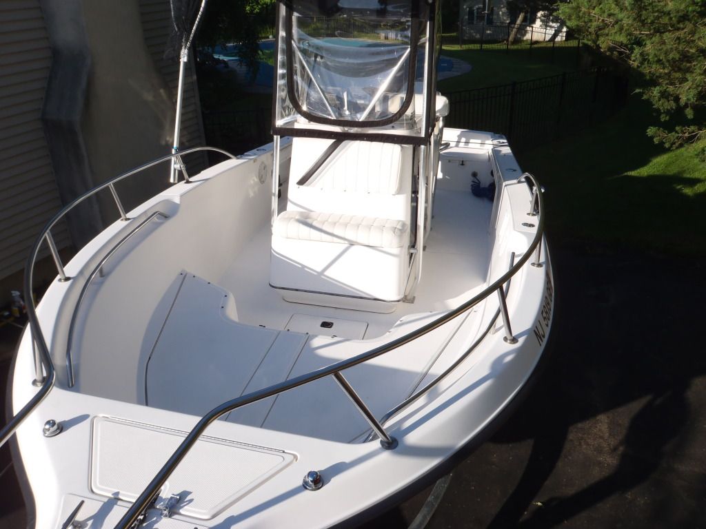

Man, that is a fine lookin ride. I did not realize the hydra sports had such a nice layout. I'm a big fan of usable fishing space without a bunch on seating, hence my love for my 81. Be happy with 15 hundo. I'm not ready to add up the cost of my current restoration but I am certain I am well above that. Congrats on having a solid ride ready for the season.

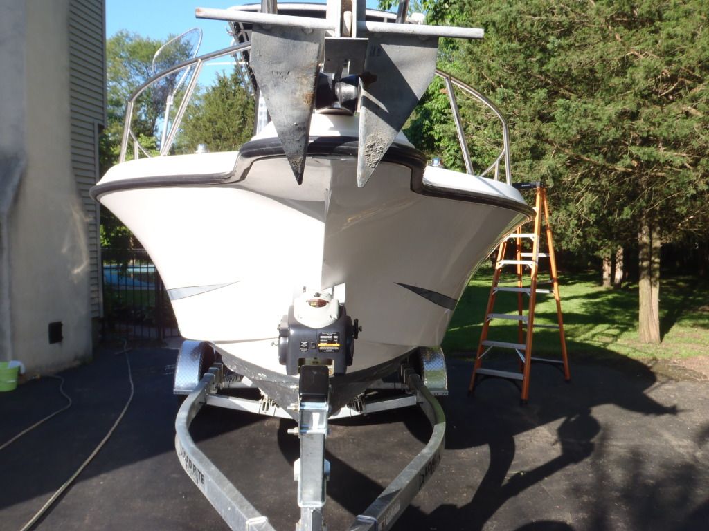

Willy I've got some troubling new for you bud... in that bow picture I noticed some mud on the anchor.....make sure you address this problem before the july event ... this will haunt me for the next couple days....

Thanks Jason, I will be trailering FishBones so the bottom paint is not a priority.
I decided to wait until this off season then I will do a full bottom job on her.
