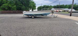

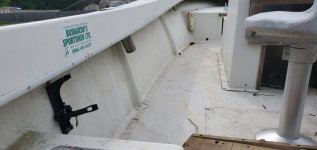

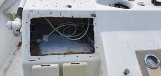

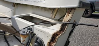

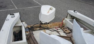

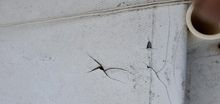

Hello fellas , I just purchase a wellcraft cc and I'm very happy w purchase been looking for one. I been looking at alot of threads on here and I'm extremely excited to get started on this project Im a beginner to boat restoration so I will be asking some questions if I cant figure out through threads thanks in advance..First thing first boat needs a new transom guy I purchased from tried his Dad owned boat since new was in garage but son left outside for 2 years .Floor is actually solid which is hard to believe but does has some stress cracks and chipping also gas take is under console which I will be taking out and redoing console ..Any information is valuable to me and I appreciate your feed back .

wow, you got a lot of grinding in your future. you don't say if your going to re-power or not, but if so, i'd look into going with at least a 25" transom. if you think the stringers are good, look at skunks transom rebuild using the pour method.

Yes I do got alot of grinding and work ahead of me to get what I'm envisioning . Far as repower I'm going to put a brand new Suzuki 150 on it. Was thinking at work today I am going to tear out floor I liked the way Kracker Jack did his rebuild also to know what going on for sure . I love the look of this boat and been out out on a couple old wellcrafts . So w that being said let the fun begin I dont want to wastefully spend but this is an investment in something I love to do and that fish in peace no worries.

I think the 70's boats did not drain overboard. If you are all-in, think about raising the deck and adding scuppers. Definitely go 25" transom.
Not sure if the 70's transoms were flat across. If so, you could do a plywood or Coosa transom easily. the later hulls have multiple angles to the transom..
Thanks for input Skunk, I'm going w coosa transom and stringers .My neighbor is retired he worked at Viking Yachts for years and will assist me in project .Also raising transom and far as scuppers it does have them on both sides of motor. One thing has me curious the gas tank is aluminum and the previous owner covered it w resin ,actually a nice tank going to get its pressure check make sure good and use it . Will send pics when tear down starts busy w 9 to 5 job at the moment
Hey as long as we re spending ur money and sweat equity, go with a full transom and a bracket.

T One thing has me curious the gas tank is aluminum and the previous owner covered it w resin ,actually a nice tank going to get its pressure check make sure good and use it.
Ethanol gas corrodes aluminum. That's the dirty little secret that the gas companies and the corn growers don't want you to know. That's why they ship the ethanol in trucks and blend it at it's final destination rather than blending it into the gas and sending it through the pipelines. The pipelines are made of aluminum and would corrode and leak. The PO probably covered the tank in resin to seal any leaks that might appear as the tank corroded from the inside out. :head:
