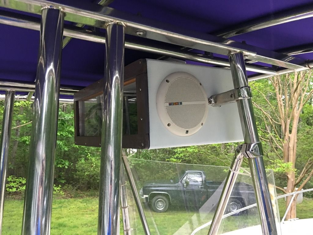

Today I pulled the electronics box off to see what my options were to get the purple off. It's made of wood and seems it was glassed over and painted. I sanded down the surface good and put a coat of paintable bedliner with a fine texture finish. That's drying tonight and tomorrow I plan on painting it white. Depending on how much this hardtop is going to cost I may be wasting my time as the plan is to mold a box into the top. But I'm waiting on some motor parts to come in so I had to do something constructive.

Got the electronics box done this afternoon. Just in the nick of time, thunderstorms started moving on in. Nothing more eerie then holding onto a stainless T-top while lightning lights up the sky. Anyways it's not perfect but it will hold me over til I can either buy one or get a hardtop made. Still haven't made that decision.

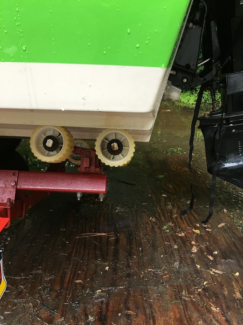

I had to make a few adjustments to get the rollers off the chines. I got that all straight but I think I have a bit too much tongue weight. Looks like I may have to bump the axle ahead a bit. I'm gonna take it to my buddy's race shop and put the tongue on one of his scales and see what I got. Anybody know about how much tongue weight I need? I guess the best thing would be to put it on 3 scales (under each tire and tongue jack) to get the exact weight. I read the tongue should be 7% of the total weight but not sure if that's just the boat or boat and trailer.
Anyways right now this is where my rear rollers are sitting. Should I try to get them closer to the transom or should this be good?
