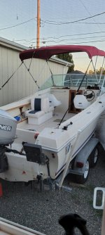

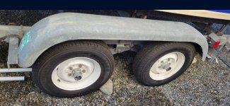

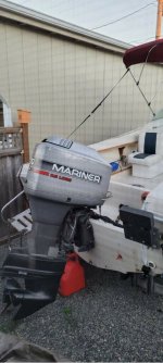

Bought this V-20 in Washington near Bremerton in late 2021. It need all the usual items but the bones were good. Motor is a tried and true Mariner 200 2 smoke. Wanted to space it out and do a 5 year plan on her. First step was to remove old items that were bolted on and didn’t work, re wire, install some seats and give her a sea trial.
